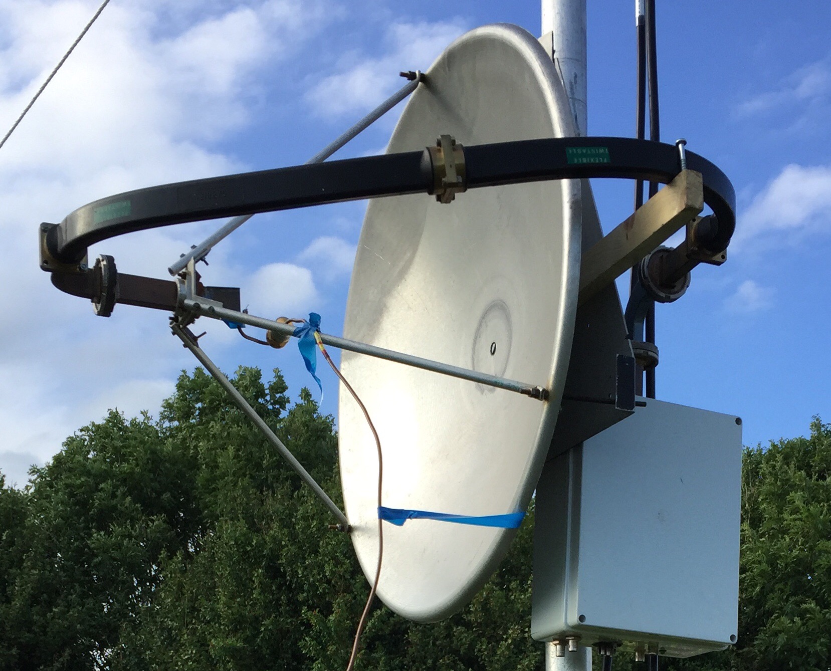

About 20 years ago, I bolted 3 lengths of aluminium tube (flattened and drilled through at each end) as a sort of tripod to reach the focus of this 60cm dish. I use a flat plate at the focus to mount the 10 GHz horn as seen here, but I have another plate with a 2.4 GHz helical feed for the ISS HamTV. You could use a similar arrangement for your log periodic.
It was a rush job that I do not think would last, but it is still in one piece!
The semi-rigid is connected to a 5.6 GHz dipole at the feed point. Unbelievably it received G8GTZ at 80km.
