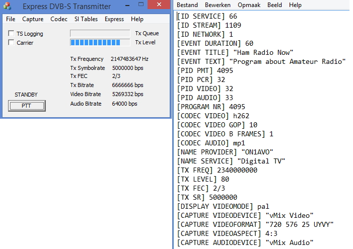

This morning I noticed another problem trying to access our local repeater ON0ATV.
When I change the TX frequency to 2340 MHz I get this weird TX freq. 2147483647 Hz.
I changed in both datvexpress.txt & .bak the weird freq. to 2340 MHz but no change still this weird TX freq.
Uninstall and reinstall Express DVB-S didn't help to solve this problem.
When I use a 23cm freq. (1281 MHz) it's alright but no luck with any 13cm freq. always TX freq. 2147483647 Hz.
I didn't encounter this when using DATVExpress Server.

G4GUO
Posts: 736
Re: DATV-Express Project - January update report
Post by G4GUO » Sat Feb 13, 2016 10:45 am
Thanks Freddy,
I have found the bug, it was a string conversion error.
I will post a fixed version later this weekend I am making some further changes today.
Here is the temporary fix
https://www.dropbox.com/s/bm1cvegsncxre ... x.zip?dl=0
- Charles
