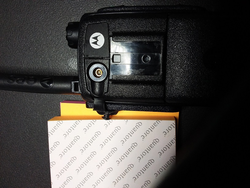

Hello all,
I recently purchased a Motorola two-way radio, Motorola TETRA MTP850s.
It is now possible to connect an external antenna at the back.
But I can't figure out what kind of plug should go in there.
Who knows ? ? all I know is that it needs a female plug. (se photo )
Kind regards,
Jan / Pd0hni

Re: Need help ...........
Hi Jan

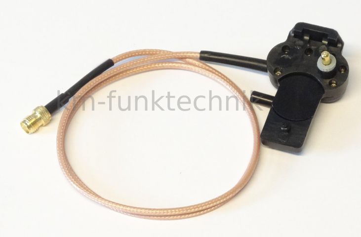

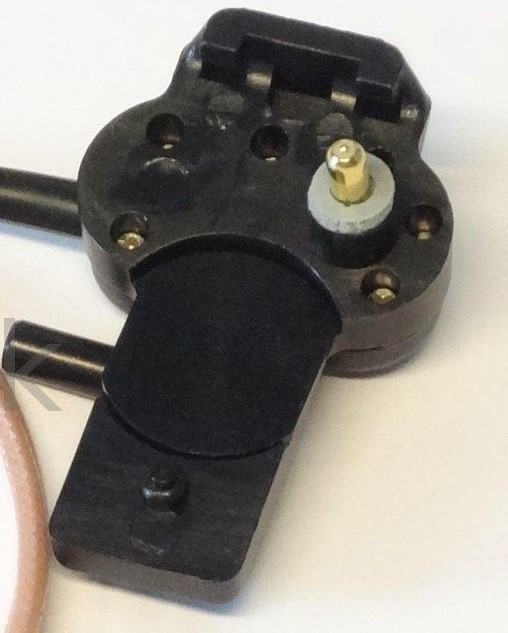

Motorola don't make things easy, that rear connector is for a craddle or this antenna adapter: GMLM5099 -75 Euros

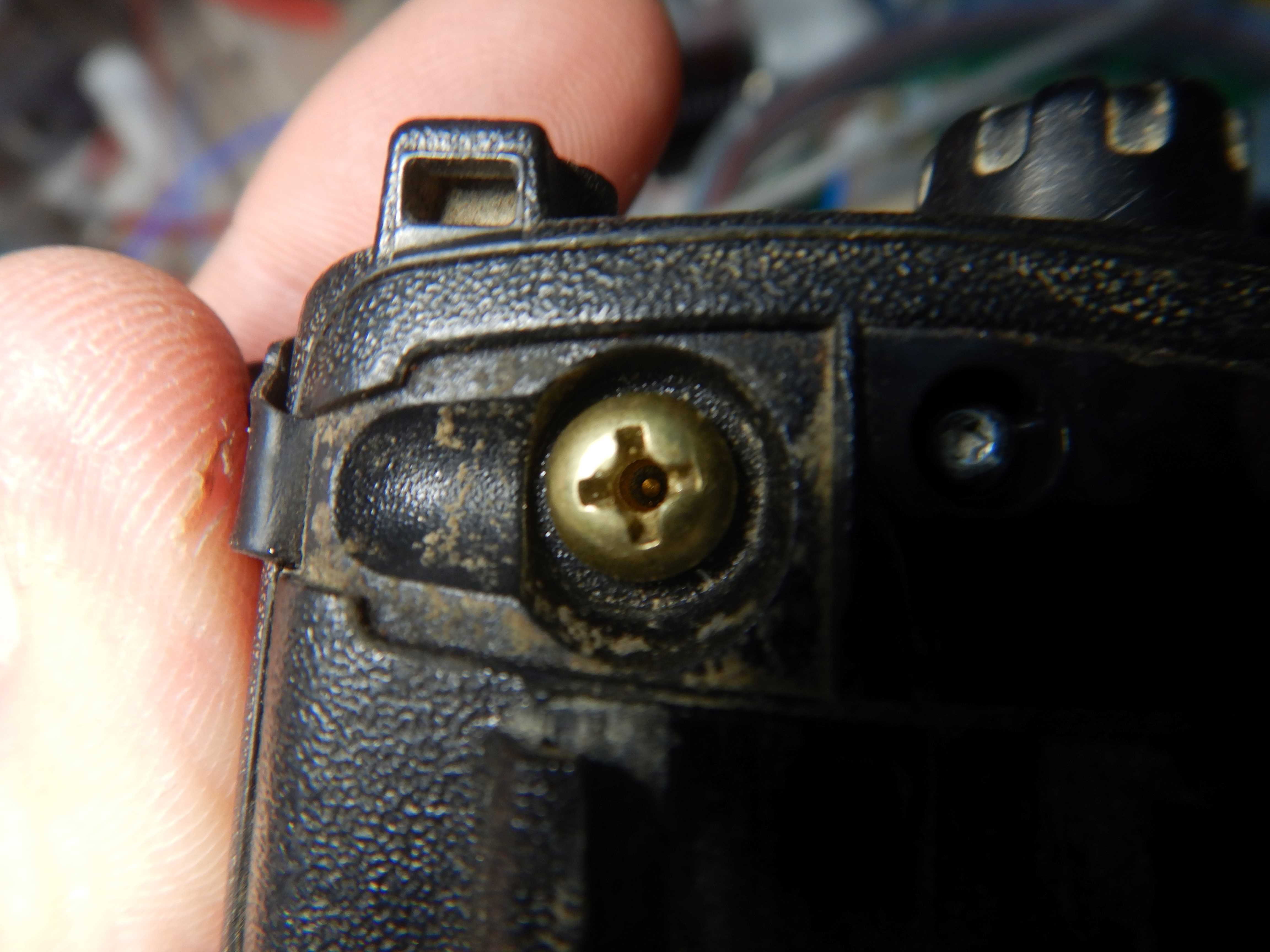

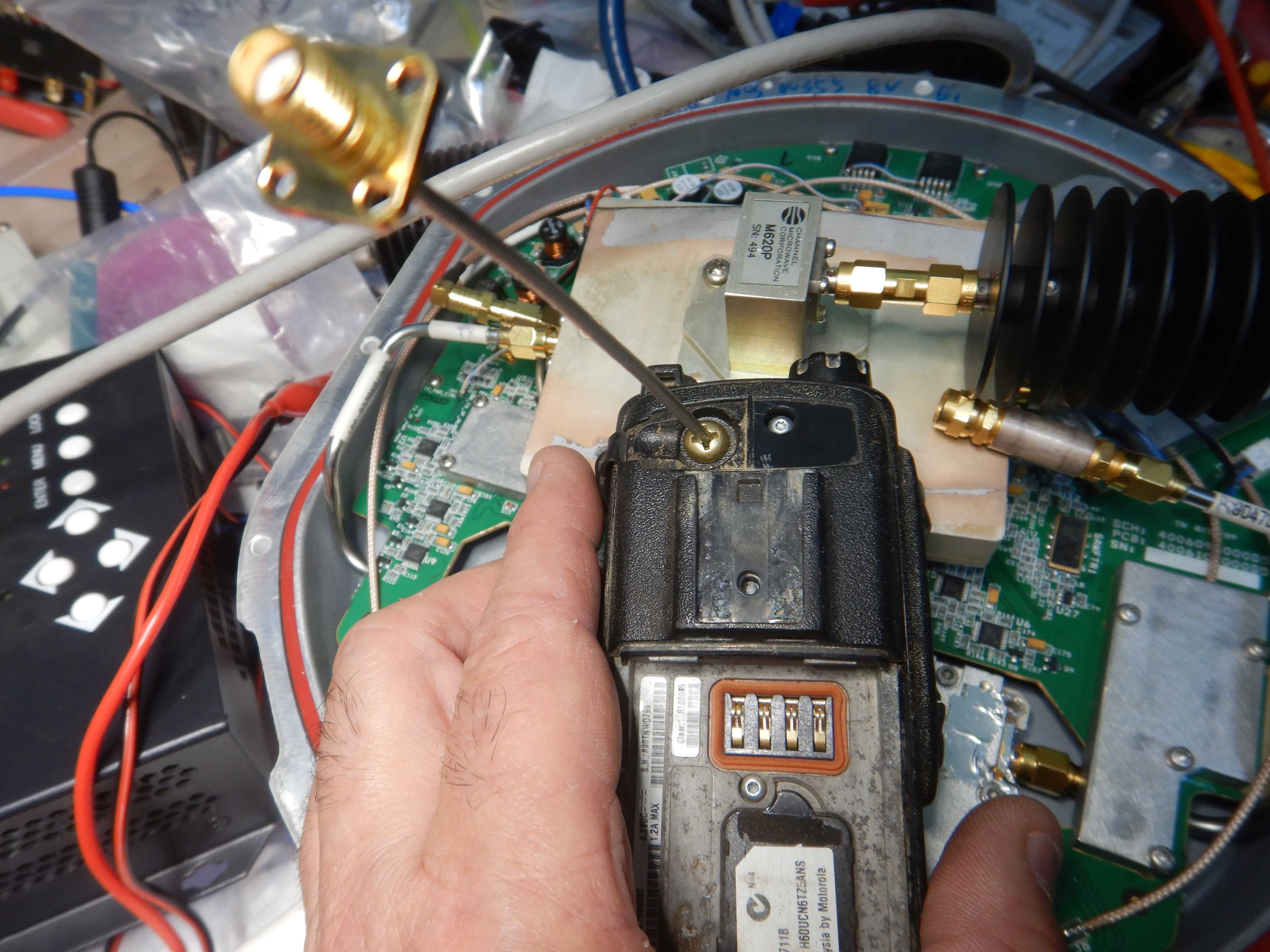

Hi Jan
A 5mm brass screw is a snug interference fit (the antenna thread is 5mm that's how I found that out)
I drilled a 2.2mm hole through the head of a short 5mm screw (drill through the antenna stud if you don't have a screw)
Bevel the thread slightly, then screw in till it mates with the "earth" outer
You can measure around 12 ohms to the right hand battery terminal
Allow around 1mm of the inner of a short lenght of .086 hardline or semiflex to protrude (trim the shield and dialelectric 1mm)
Push the coax through the hole and when it mates there is a small amount of spring pressure
(There maybe a switch underneath to swap from the antenna to the dock socket)
With the spring depressed mark the coax position against the screw, remove and solder
You should be able to measure 0 ohms to the right battery terminal
For some reason motorola handhelds always have the antenna at Ground (0 Volts) does anyone know why?
Maybe to keep us out grrrr.
Motorola is so expensive, anything to hack their stuff is always a pleasure, have fun on your Tetra adventures
Cheers Roger VK5YYY

I have also found a company in Germany that sells the complete cable.
But I was shocked by the price: 80.00 euros + shipping costs.
So I'm going to try your way first. Hi
