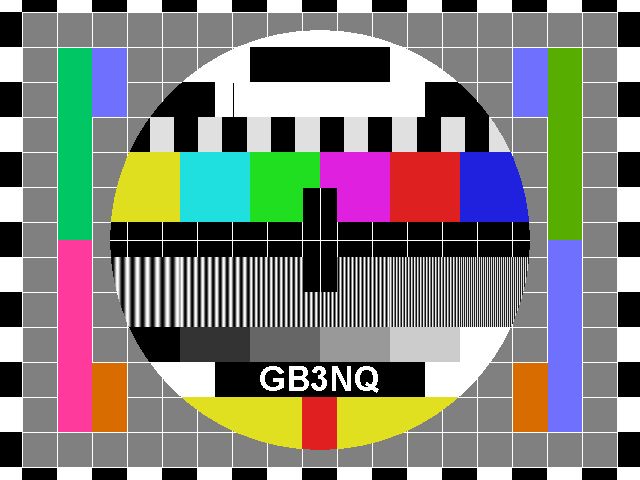

How about a PI Zero. Move all desktop short cuts off, and make the background the testcard 640x480 works nicely..
You can go a bit further and upload various Testcards.jpgs and use FBI to play them as a slide show.
I use a normal PI but the zero will work as it is not working that hard doing this.
- GB3NQ.jpg (45.16 KiB) Viewed 8576 times

Many thanks for your interest and the excellent caption. The G3RFL unit worked well for 18 odd years I think.
