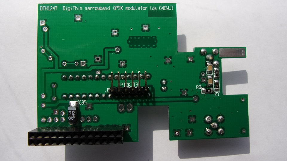

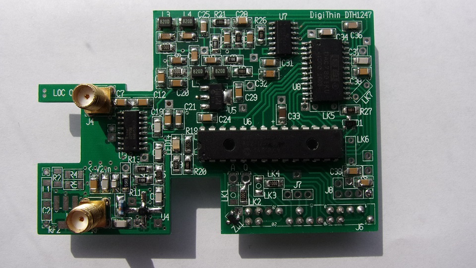

Top and bottom with slightly better lighting than my last.
