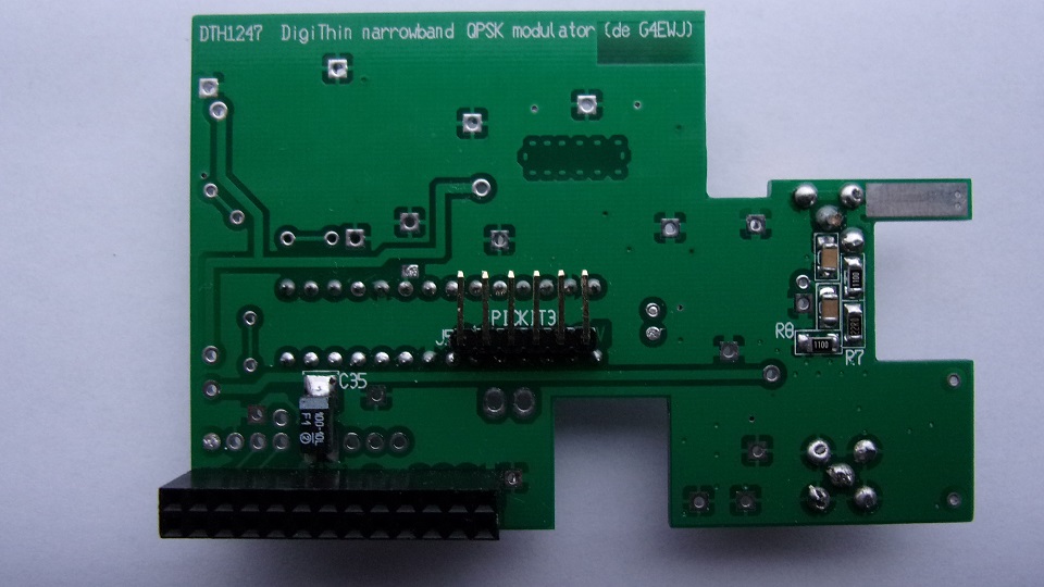

Actually my question was not about software but building the hardware. The instructions are fairly sparse. You really need to know what it looks like before you start. A few photos would help a lot.

Post by G4EWJ » Wed Aug 19, 2015 6:47 pm
There's a photo of the top here. I'll do a photo of the underside.
http://www.batc.org.uk/forum/viewtopic.php?f=97&t=4142

Post by G4EWJ » Wed Aug 19, 2015 7:16 pm
Here's the underside. The lighting in here isn't very good. I'll replace it with a better one tomorrow.

Post by g0mjw » Thu Aug 20, 2015 7:04 am
Thanks - that's really helped. Especially with respect to what to do with the connector
