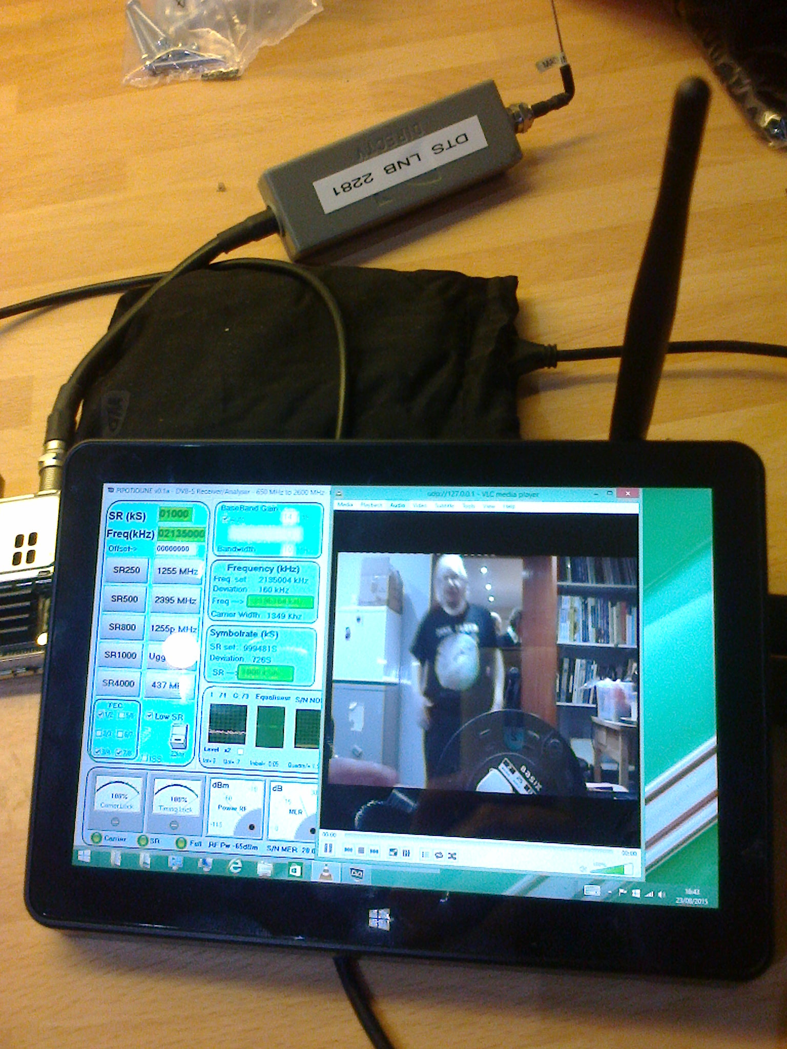

I have just modified the SUP2400 with the 8.912 crystal giving an LO of 2281.6 MHz (I guess that makes it an SUP2281!). Fairly easy to do - I actually broke the big lump of solder on the crystal case off with cutters rather than try to desolder.
The 437 performance at 1844.62 MHz was the same as a normal SUP but the 146 MHz output at 2135.1 MHz was about 10 dB down. More investigations to do to find out where it is rolling off but maybe this can be overcome by 146 MHz pre-amp / filters.
If it can be made to work, it does become a very simple and cheap up converter for 146 MHz.

Coincidentally, I was able to test the SUP-2281 at Warrington ARC yesterday.
I used the slightly agricultural ballistic de-soldering method - heat the blob with a big iron and bang it on the table.

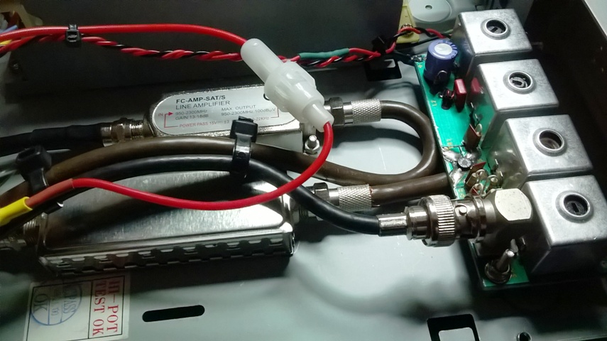

Following on from advice from Terry and Posts from Brian & Noel.
I now have a fully working MKII self contained 146.5 Rx with Pye R4002 base station front end, Sup-2400 and sat booster,
plugged into TT-1600 board in my portable Pc, with pre-amp to mount on the Yagi.

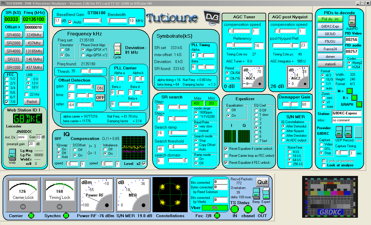

Playing with the Xtal swap on another SUP2400 have tested this on the TT-1600 on 21351 all working fine,
also works "very well" on TT-3200, with Baud Rate set to very slow in SR Search Box Expert mode,
as pointed out by Shaun some time ago.
