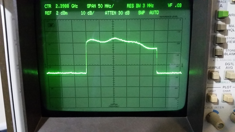

I did a sweep this evening of the VCO/lock range of the SUP 2400, see screen shot below. Mine is 9.375MHz reference crystal as standard.
Freq range as-is can be 2300-2560, you could modify the vco components to shift it lower.....
That gives 9-10MHz crystals as a possibility.
- SUP2400 LO range as standard
- 20150727_194016.jpg (129.9 KiB) Viewed 23148 times

I must have been wrong about the 8.192MHz crystal working and the 8.912MHz crystal was just scraping in.
