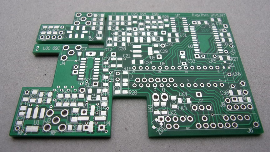

Post by G4EWJ » Sun Mar 01, 2015 2:13 pm
The DigiThin pcbs have arrived and a few have gone out to early testers. The digital-analogue converter has proved to be difficult to find, but there's a consignment coming, literally on a slow boat from China, so it may be a few weeks before parts get into the BATC shop.
The top left section is a break-off that will take an Si570 synthesiser. The idea is that it fits under the DigiThin pcb on J8 and connects to the I2C port on the Raspberry Pi and provides the local oscillator for the modulator. They come in various versions, going up to and above 1.3GHz. The cheapest one goes to 160MHz and costs £12. It puts out a few milliwatts, so it may be possible to filter the third harmonic and use it for 437MHZ as well as 147MHz.
It's untested as yet. It was just an idea to fill up part of the rectangular pcb space.
