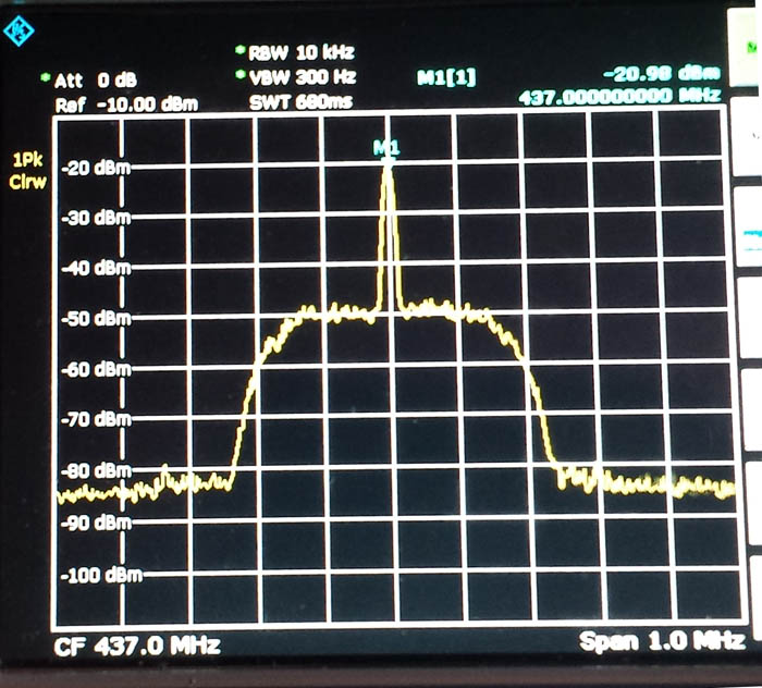

I have started for the first time my Digithin this morning.
- Pidatv image 1.2.1
- raspberry model B
it seems to modulate well, but I have a big carrier remaining.
input is 437MHz . I try between -10 and -20 dBm, it changes nothing.
first test.jpg (117.47 KiB) Viewed 21185 times
Have you an idea to fix this?
thanks
Jean-Pierre F6DZP
Re: big carrier in the middle of my modulation
Post by g8gtz » Tue Jul 07, 2015 9:54 am
Hi jean Pierre
Looks like the digithin isn't actually getting the right data stream from the Rpi. With an LO of -20 DBm the output when correctly modulated should be 0dBm.
What's the LED doing? It should be flashing every second - if it's not that's the problem and you need to check you're running 333Ks and if you are playing a TS file it is recorded at right bit rate...

I have a 20dB attenuator before my spectrum analyzer.
led flash every second.
All seems to work, but there is that high LO signal that remain..
I suppose I must check the level of IQ that go in the modulator, perhaps they are too low?
Jean-Pierre F6DZP

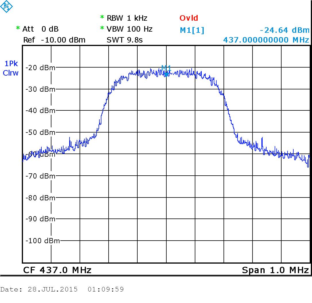

Post by F6DZP » Tue Jul 28, 2015 11:48 am
I have changed the modulator by a new one sent by Brian (thanks).
Now this problem is fixed.

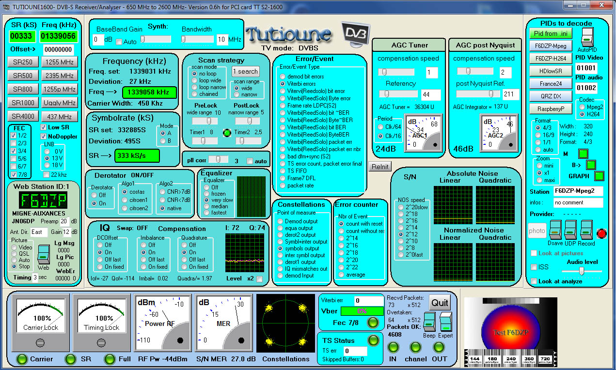

when I receive on 437Mhz, max MER is 27dB.
Tutioune1600 digithin 437 SR333 MER27dB R500.jpg (476.22 KiB) Viewed 20966 times
using R21=390 ohms, 120mV I have now 29dB MER
