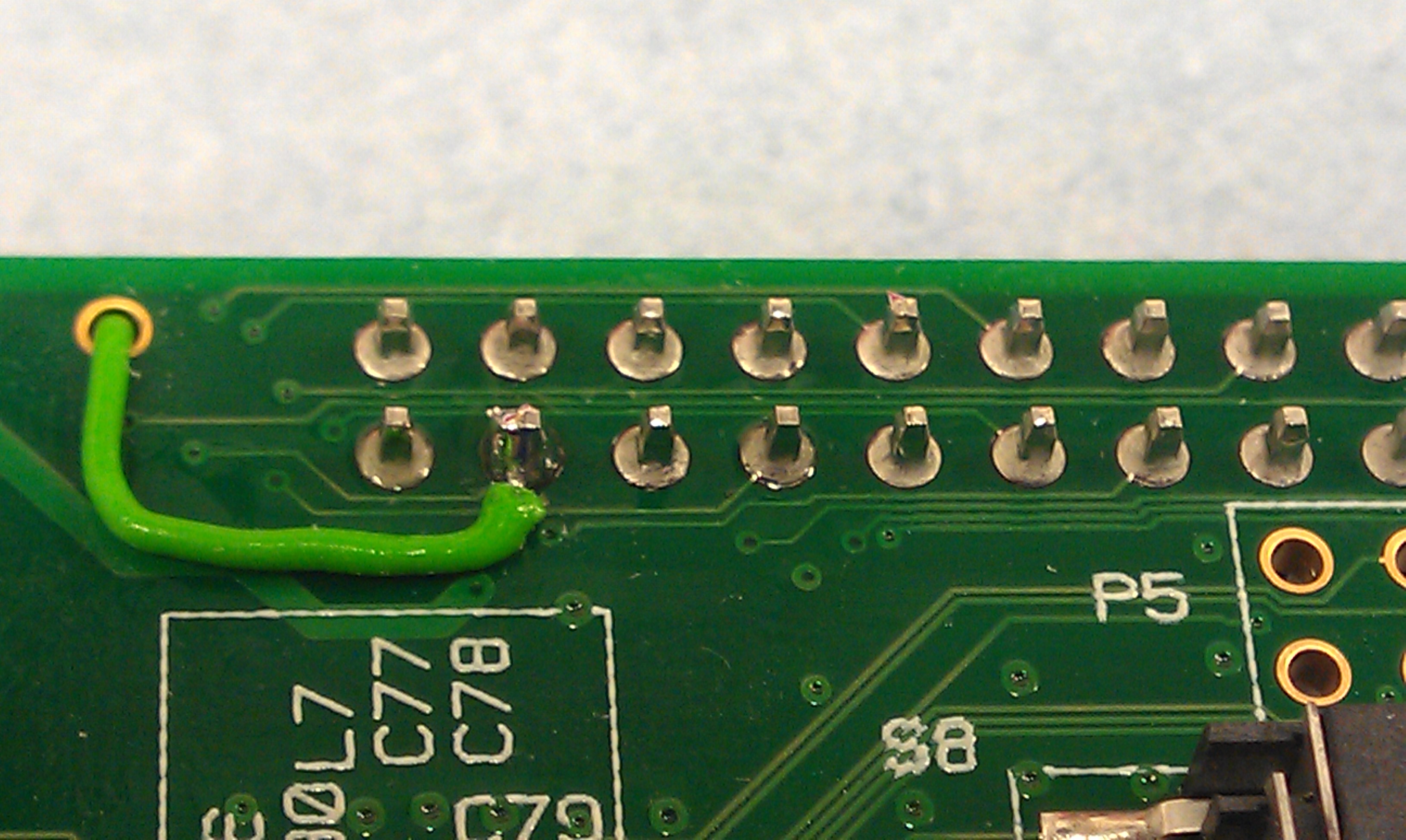

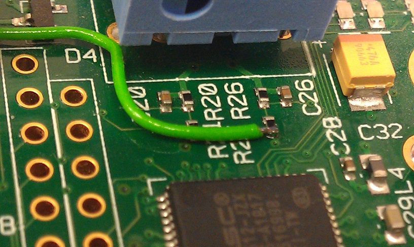

If You have a Raspberry Pi Model B, (not B+) only one of the I Q signals is connected to the gpio header.
The 'I' is already connected but you will need to run a wire to connect the 'Q' as detailed in the instructions.
The photo in the BATC article is a little small to see where to connect it, so am posting it here.
