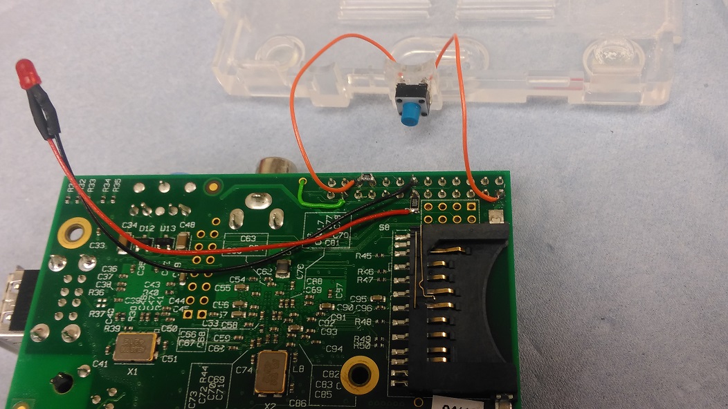

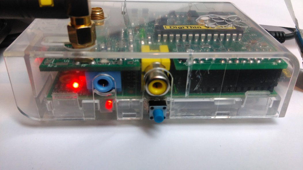

Some users have reported corruption of their DigiThin installations possibly due to powering down the Raspberry Pi while it is still running. Phil M0DNY has now come up with a solution. It allows the RPi to be shut down tidily by pressing a front panel button, and then provides an indication that the shutdown is complete. Details of his software are here: https://github.com/philcrump/pi-sdn
To install this facility, first wire a push-to-make button between pin 22 on the RPi GPIO header and the 3.3v supply (available at pin 1 of the header); also put a 1K resistor between pin 22 and ground (for noise immunity). Pin 22 connects to RPi GPIO 25, which is WiringPi pin 6. The utility uses WiringPi numbers. If you want an indication that shutdown has taken place, wire an LED to ground through a 1K resistor from pin 13 on the RPi header (RPi GPIO 27, WiringPi number 2).

Phil and I would be grateful for any comments on the utility or the installation instructions.

Many thanks Dave,
Have tested on two model 'B's and on A Pi 2
Works fine on all three, very handy :D
