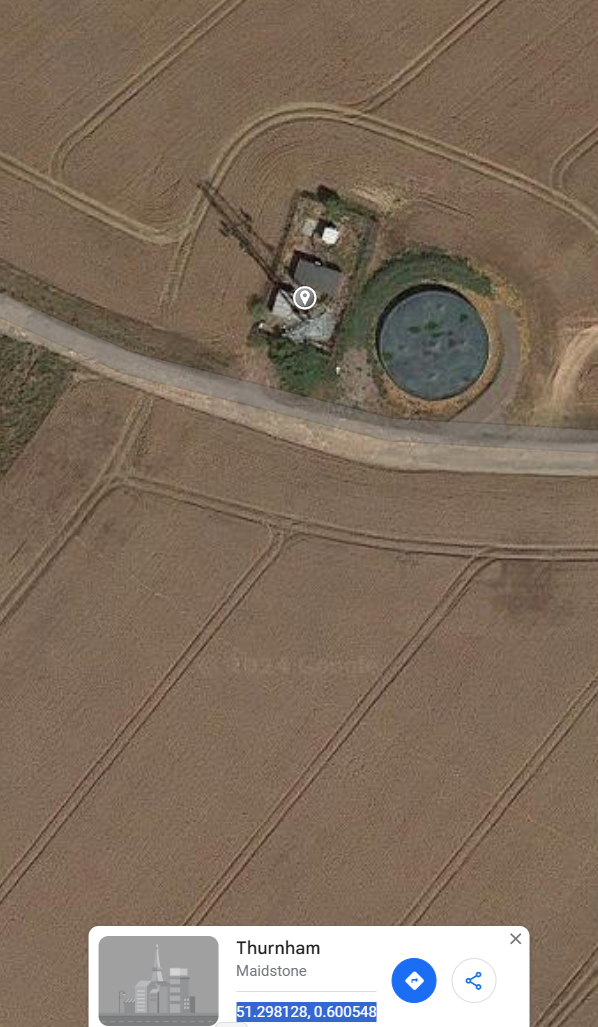

Following the long standing issues at the Hastings site (even though it was an excellent locations), and then temporary move to Eastbourne (which had coverage issues), I have now moved west of Maidstone in Kent.
An application has been submitted for site move and hopefully if accepted, I can get the DATV repeater back on air as soon as possible.
Dave G8PUO

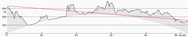

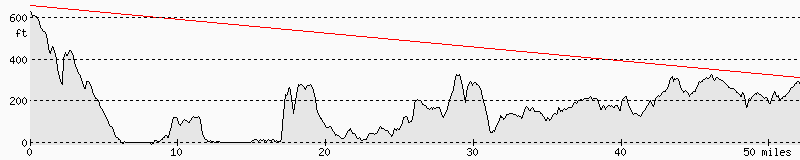

Re: GB3JT Site
Posted: Sat Nov 23, 2024 7:17 am
by G4HTZ
Sorry forget to add , these are from Detling to my QTH assuming mast heights of 30ft each end

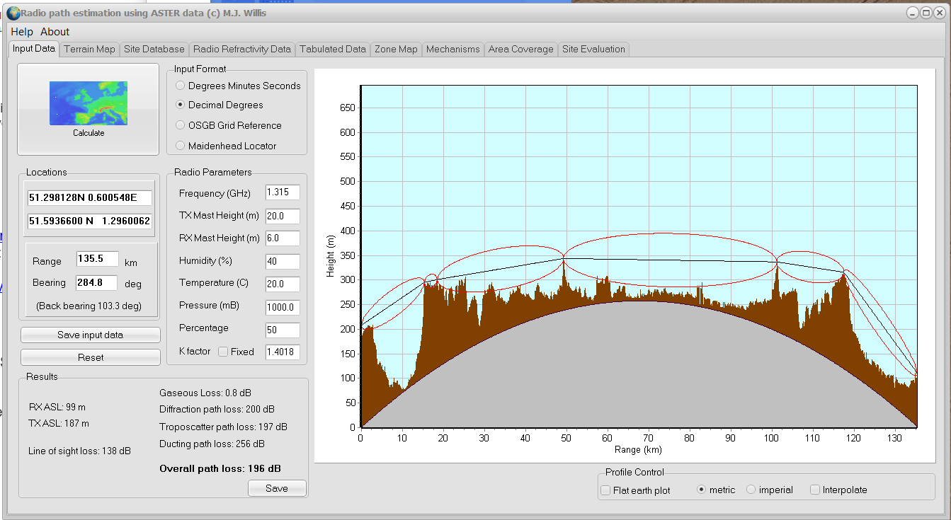

Re: GB3JT Site
Posted: Sat Nov 23, 2024 9:10 am
by g0mjw
Assuming I have the right place?
Screenshot 2024-11-23 085351.png (716.8 KiB) Viewed 11141 times
How high is the antenna and what is the EIRP? If I assume 1kW which I suspect too much for the repeater itself but not unreasonable for someone trying to get into it and the repeater antenna at 20M above ground from the site shown I can get a rough idea of the coverage using path profile taking into account terrain and that the earth is not flat, but not and effect from trees etc that may be in the way
Screenshot 2024-11-23 085333.png (78.33 KiB) Viewed 11141 times
So not great for me, but that's to be expected. Coverage seems to favour the east and south-east as is usual from Kent. I have attached a very crude coverage plot inside the zip for google earth. What this means depends on power, antenna gain etc. but probably green, yellow, orange and red pixels have a shot.
GB3JT.zip
(46.19 KiB) Downloaded 621 times
Re: GB3JT Site
Posted: Sat Nov 23, 2024 11:10 am
by Basil
I presume the curvature of the earth is grossly exaggerated, visually? Otherwise two points about 130kms apart occupy about one eighth of the world's circumference!
Re: GB3JT Site
Posted: Sat Nov 23, 2024 11:15 am
by g0mjw
Yes, otherwise you would see noting but a flat line. The curvature is accurate in relation to the terrain height. A path that long has over 200m of earth to get over, even on a plain with no hills. This is why in open flat terrain or on the sea, the horizon is a few km away at head height.
