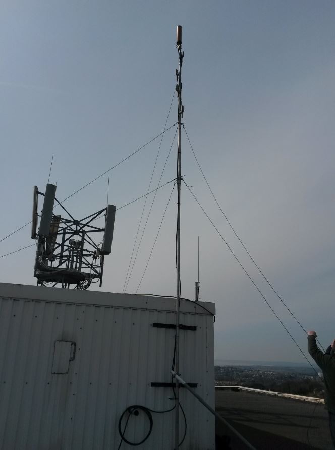

Two repeater masts
One of two racks

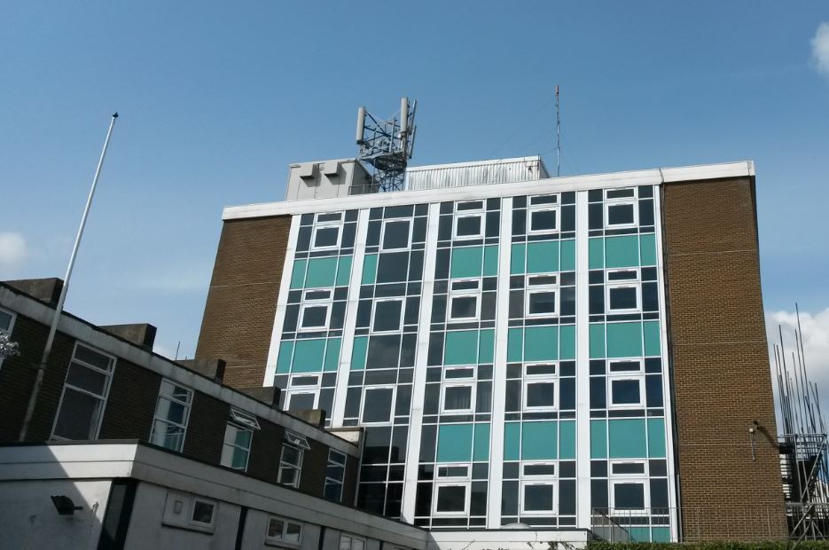

The Tower
View from the roof, antennas another 20' higher!

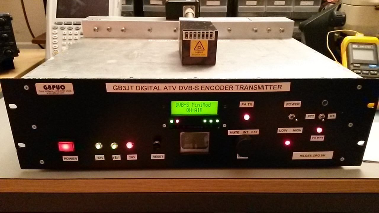

GB3JT TX and PA, WIP cased and on soak test.
GB3JT WIP cased.
GB3JT WIP cased.

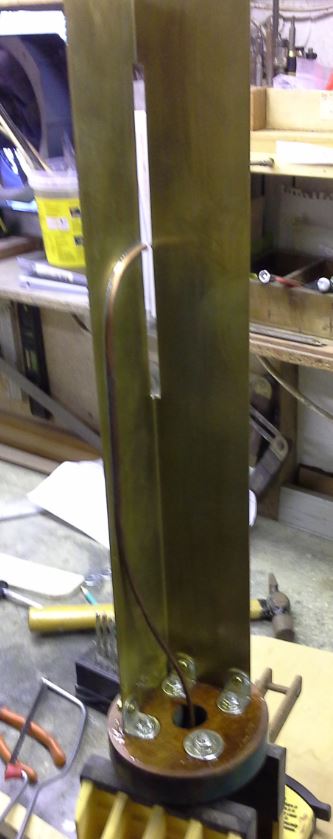

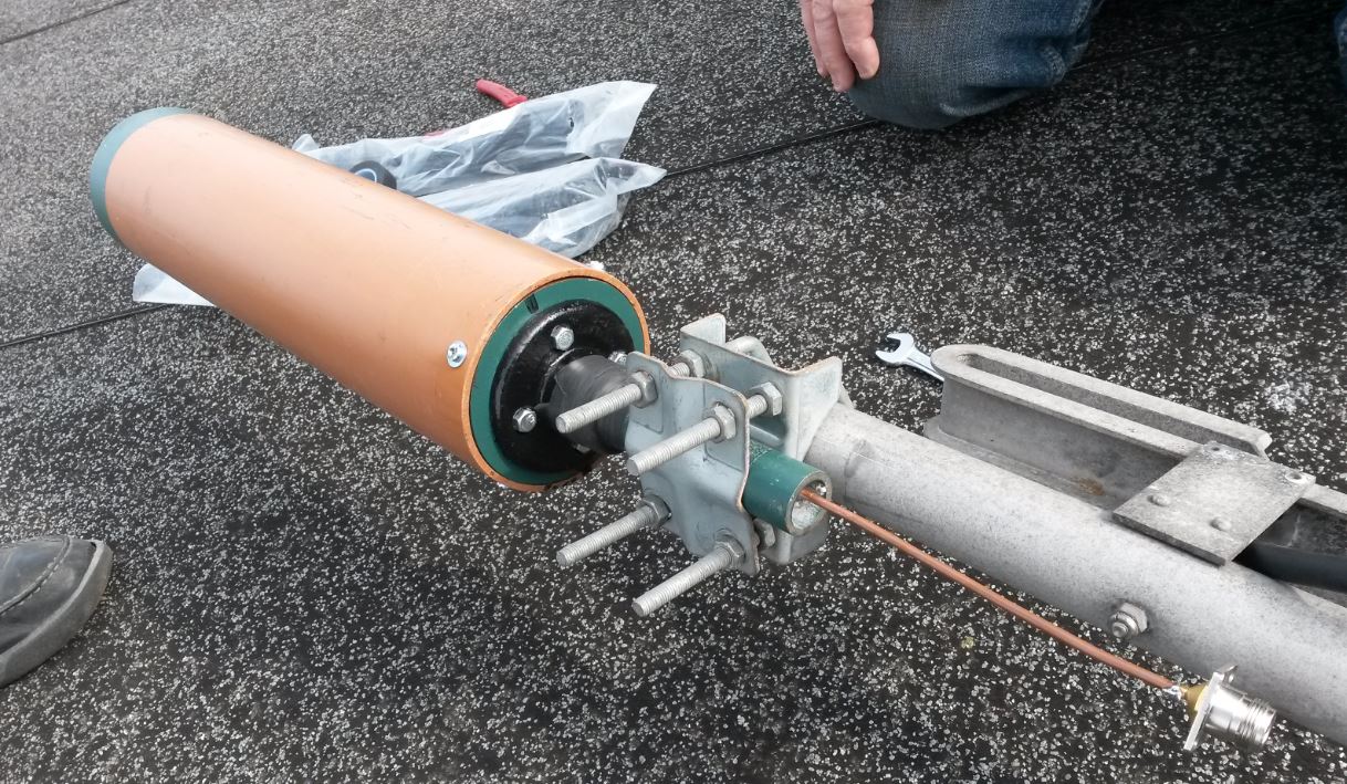

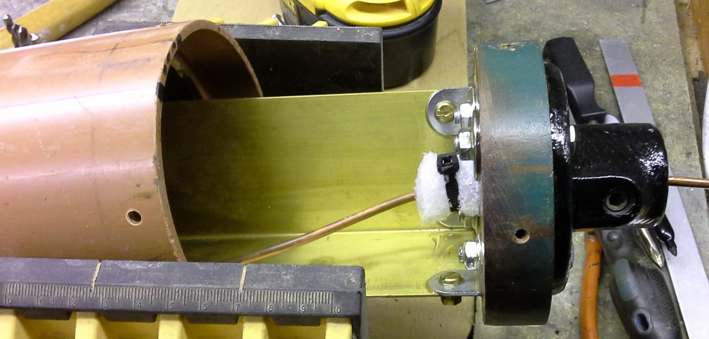

Have been asked about the antenna. This is an angled slot made out of brass plate and mounted within a tube. It is then mounted on top of the main GB3HE four stack mast, on top of the school tower block - so well in the clear.
GB3JT Angled Slot Antenna.

GB3HE GB7HE GB3JT Site Mast

GB3HE GB7HE GB3JT Tower Block

Very nice antenna.. We use them on GB3BH. Dave, G8ADM
