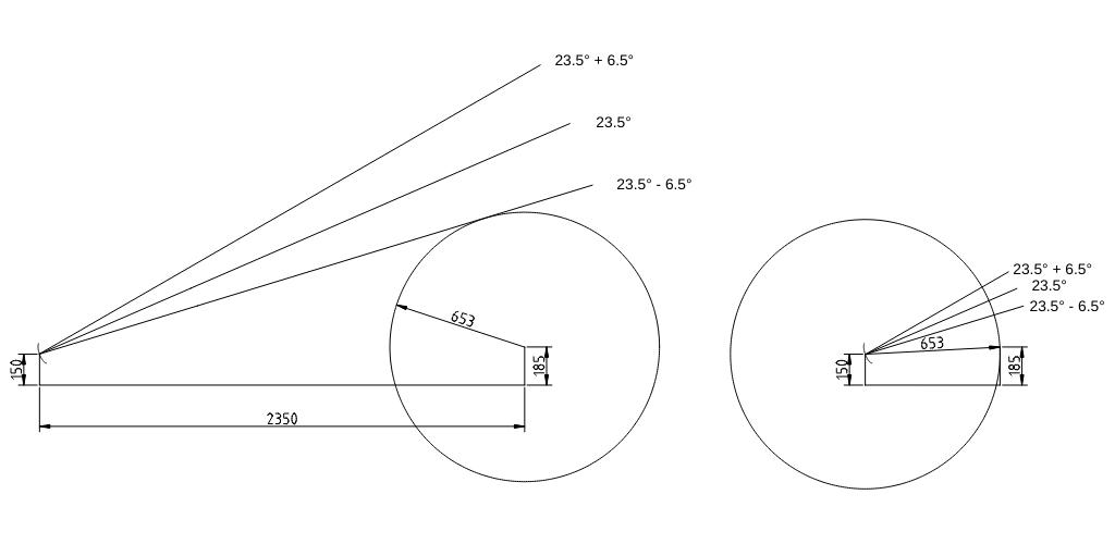

So I turned to a simple CAD drawing package to get ideas down into my head.
My centre of the dish is at 1.5 metres from the ground, the elevation to the sat is 23.5 degrees, so I have drawn lines for that and also the 9 dB down beam-width. I have also assumed a person at 1.85 metres tall.
At first I was way off on my ideas, but included here so others do not make the mistake I did. The first idea gave me a safe distance of over 23.5 metres which was more than standing in the direct beam, so I had a rethink: -
In the second half of the image, I am basically saying that if the top of the person is not within the -9 dB beam-width the safe distance is going to be 6.53 metres, and even at that distance I could actually have 1.57 metres clearance from the -9 dB beam to the head of a person, but can not back that up with any calculations.
How to account for 10 minute periods rather than 6 minutes of constant transmit I am not sure.
I would appreciate comments to see if anyone thinks I am on the correct or wrong track with this.

One valid approach would be to apply a sidelobe mask - that is a maximum level the sidelobes will not be above. Start with the first null beamwidth and assume within this the gain is the same as boresight. The first null is about 70 * Wavelength/Diameter, measured in degrees from boresight - this is approximately plus or minus 4 degrees for a 2.4m dish and +-8 degrees for a 1.2m dish. Assume everywhere else it is 13 dB down. That is the level of the first sidelobe assuming even illumination. Any decent feed would normally be much better than this. This represents conservative assumption but if the test is passed at that level then nothing more to do.
If it is not then a more complex calculation is going to be needed, but really it should not be needed. We should not be operating so close to the wire that we need to worry about sidelobes containing power 20 times less than that in the mainlobe.
