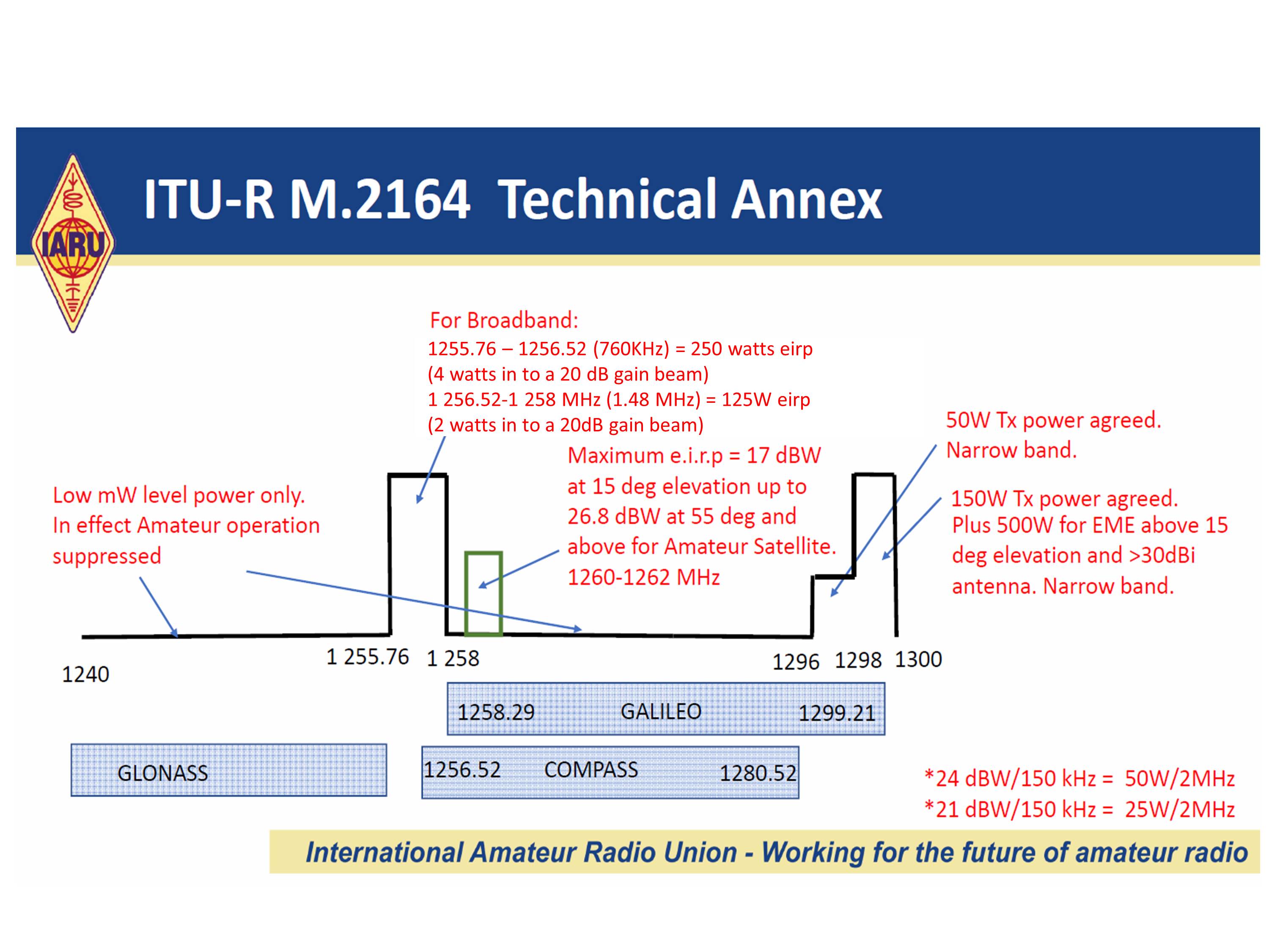

what I'm not sure to understand is:
For Broadband:
1 255.76-1 256.52 MHz: e.i.r.p. = 24 dBW/150kHz*
1 256.52-1 258 MHz: e.i.r.p. = 21 dBW/150 kHz*
and
*24 dBW/150 kHz = 50W/2MHz
*21 dBW/150 kHz = 25W/2MHz
in the last slide...
best 73
de
i2NDT Claudio
i2NDT Claudio
Dalmine, Italia
g4eml
Posts: 804
Re: IARU 23cms update
Post by g4eml » Thu Nov 23, 2023 5:15 pm
I was confused by that 24 dBW/150 kHz = 50W/2 MHz as well.
I think it refers to the allowable power into the 18dB gain antenna assumed in the document. Someone please correct me if I am wrong.
150 kHz to 2 MHz is 13.333 times or 11.25 dB.
Allowable power in 2 MHz would be 24 + 11.25 = 35.25 dBW
Antenna gain is assumed to be 18 dB so power to antenna would be 35.25 - 18 = 17.25 dBW
17.25 dBW = 53 Watts
Except of course the 24dBW/150 kHz is only 760 kHz wide so you couldn't actually run a 2 MHz wide signal at that power.
So the limit for a 2 MHz wide signal would be 21 dBW/150 kHz or 25 W into an 18dB antenna.
Colin G4EML

Post by g8gtz » Sun Nov 26, 2023 5:43 pm
For those who prefer pictures, I have merged 2 drawings from the IARU presentation to show the actual power levels allowed in the PROPOSED wide band segment.
Note this is the only place ATV will exist on 23cms worldwide if this proposal is accepted - the UK will still retain 25MHz above 1300MHz for now....
