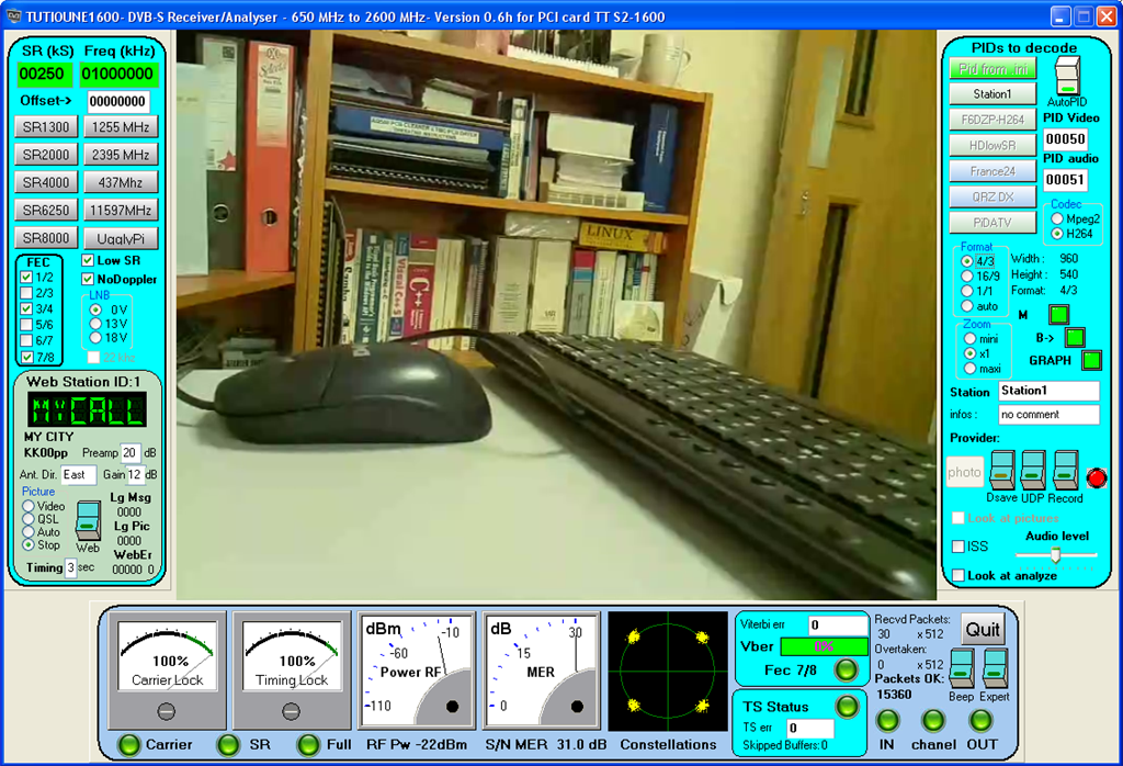

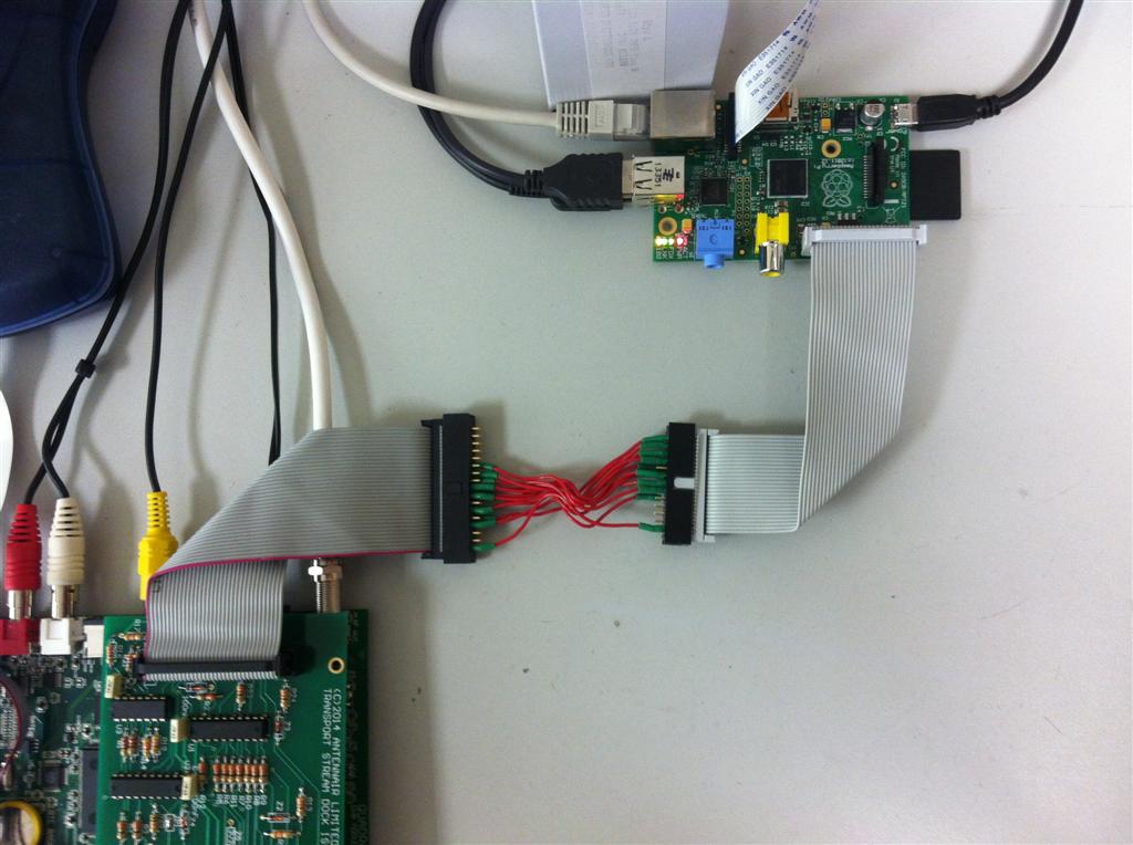

Some good news - we have the Raspberry Pi Model B streaming H.264 directly into the DTX1 TS_Dock port! Many thanks to Evariste for his support on this exciting development.
It works fine down to 250Kb/s although in this set-up we are a bit faster than that. Picture quality from the Rpi's camera is very good!
- NBDTX1 (Large).png (948.76 KiB) Viewed 27180 times
The electrical interface on the Pi is physically on a 26 Way Header so there's a little inter-wiring to our 34 Way header but no electronics just a very few wires...
- photo 1 (Large).JPG (96.53 KiB) Viewed 27180 times
Connections from Model B Raspberry Pi to DTX1 TS-Dock PCB.

You could make up a single short cable to do this rather than use two ribbons and wires.

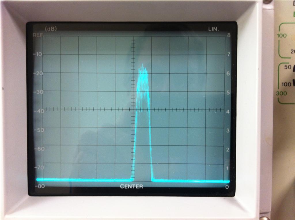

Oh and the spectrum is clean too! On this shot each division is 0.5MHz.
