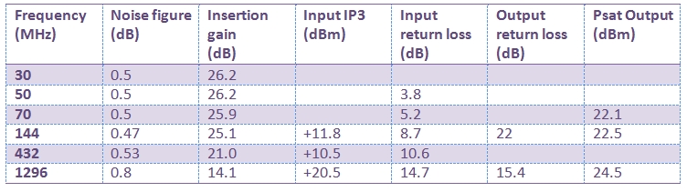

The PGA 103 amplifier published in the last CQ-TV is ideal as a first stage driver with performance as shown below and you could possibly use 2 stages with careful gain balancing.
However, in the next edition of CQ-TV (publication date December) there will be an article on a PA stage which has been designed to be driven by the PGA 103 and gives 2.5 watts when used for narrow band operation - DATV operation has not yet been fully evaluated but should be similar. We are looking at the potential of stocking the PCB and or components / kits in the BATC shop.
