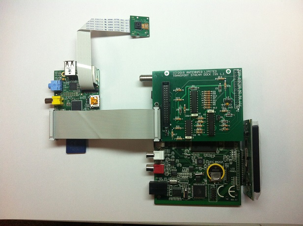

For those of you who didn't make it to CAT15, you might like to know that the BATC shop is now stocking Version 1.1 of the TS Dock PCB. This has a 26 Way connector (as well as the 34) and the 26 Way goes directly 1:1to the Pi :) Much neater !
New boardsmall.jpg (92.39 KiB) Viewed 24547 times

I have just finished the issue 1.1 TS dock board. When I used the second channel board, the DTX1 detected it and displayed a second arrow on the display. The TS dock board does not do this. I have connected the Pi and set it to DTX1 output mode. The red camera light is on and I know that the camera works OK, because it displays a picture with the raspivid -d command. I am not getting any output waveform from the DTX1. I have no facility to update the DTX1 firmware to the new version with a preset for Pi operation, so I wonder if someone who has got this running could write a few notes about the correct menu options to select and what, if any, indications the display shows. I am confused by some earlier posts on this thread that seem to imply having two transport streams in operation; how is this possible as the DTX1 has only one RF output?

We would not expect the DTX1 to detect the TS Dock board - that's normal. (There are no I2C devices on it that the firmware can look for!)
If you think about a normal broadcast RF signal, it's a multiplex - after all you have but one aerial socket on your TV yet several 'channels' (really programs) now happily live in the same bandwidth as did an analogue TV station. Built into our DVB encoding FPGA there is a 2 channel multiplexer. The first input channel is connected to the MPEG2 encoder IC output on the main board, and the second one presented at the header into which you connect the TS Dock PCB. You need to 'tell' the DTX1 that there is a second channel in operation by enabling it in the menu system, and for DATV purposes it's usual also to disable the primary channel or you will in fact get a wider signal to air containing both lots of data! You also need to tell it that the clock is EXTernally sourced. There are then a few other parameters to input and tbh these can be a little tricky, but help is coming!
We are about to ship a new batch of DTX1's to BATC pending Noel confirming the exact default preset contents, and at that time (hopefully this week) we will also release the latest version of firmware to existing users which will contain that enhancement. You will need a simple RS-232 lead (Tx, Rx and Ground) to re-flash your DTX1. The latest version will be announced here shortly then, and will be found at http://www.dtx1.info/downloads/firmware/ along with the PC utility to re-flash the unit. A new batch of TS Dock PCB's will be shipped too (no design changes).
