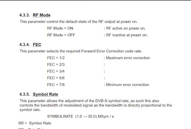

The DTX 1 boots up normally and then the top button is pressed the middle LED comes on and the device is in transmit . As part of a considered upgrade to the GB3UD transmit line up this is a minor issue and can be overcome by external means.
However the existing exciter works in a similar fashion but automatically goes to transmit after boot up , this is a useful asset as in the case of a mains failure the transmitter comes strait on, just after power is restored. Therefore I wondered if a small change in the software can easily be introduced to get the DTX1 to go automatically to transmit after power restoration instead of having to make a bit of external circuitry to achieve just this action.

you can set it in software to come on in either standby or tx mode

Hi Albert,
Page 17 of the user manual; RF Mode.
