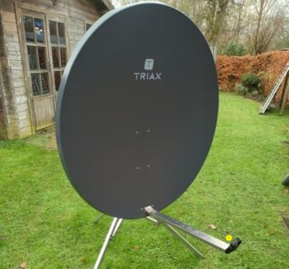

I get an Triax offset dish with the meassurements of 101 x 112 cm.
I want to use the POTY to receive the QO-100.
I understand that it is possible .. BUT .. the focus ( lens) position with the POTY can be very different then when the standaard LMB is used.
Who can help me to find out .. what I have tot do .. to find the correct focus point of this dish.
In the picture you see the dish .. still with no POTY .. only for the explanation of this question.

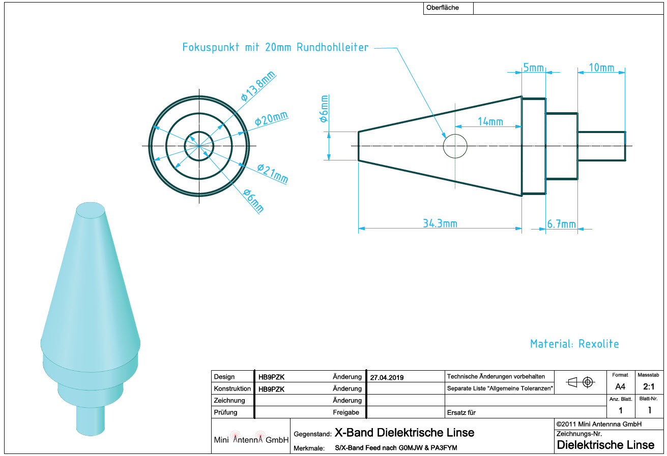

So, this is a 1m dish, not a 1.2m dish. In an offset it is the smaller dimension that counts, what you have is a section of a parabola so think of a circular dish at the satellite elevation projected on to it.
The focus is in the middle of the lens, assuming you are using one from a surplus rocket LNB, or if you are using HB9PZK's design, 14mm in front of the face of the waveguide pipe (i.e. the 22mm water pipe)

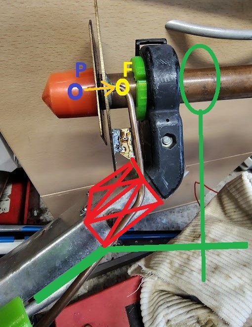

Firstly, the antenna is not 120cm (as advertised), but only 105cm (maybe even 100cm). In fact, it is TRIAX antenna. The main point for installing a feed (standard LNBF or POTY feed) is to co-locate the feed's phase center with the antenna's focal point. Antenna's focal point I marked on the attached picture with the yellow dot. I personally think that simple installing the POTY feed instead of LNBF will not be perfect. The antenna's feedarm will be the main obstacle. I think the one of the ways could be shortening the original feedarm a little and installing the fully adjustable LNB-holder to the end of it. If there is an interest in that, I could design and make one of those.

Post by RimaNTSS » Wed Dec 04, 2024 5:52 pm
That what I mean by that. Part of original TRIAX feedarm (red X) is cut off. New feed-support (green) is made and attached to the feedarm. So, the POTY feed can be moved away from the dish in such a way that it's phase center (blue dot) is moved to be co-located with the antenna's focal point (yellow dot).
