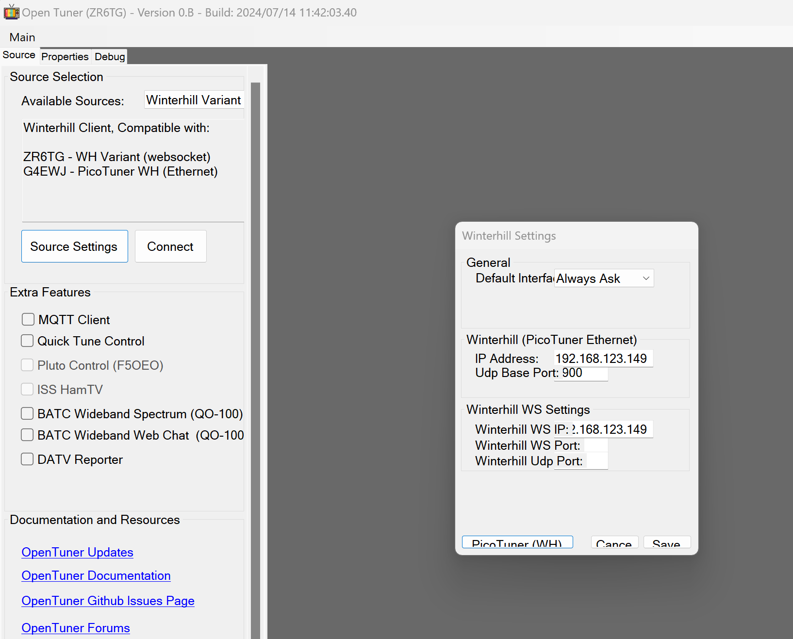

Run Opentuner on a Windows PC and then select winterhill and source settings. Then the box to show the PicotunerWH info (lower left of new box). That gives you the IP address of the tuner to set up Opentuner software.
Screenshot 2024-10-09 085809.png (118.25 KiB) Viewed 7947 times
Screenshot 2024-10-09 085629.png (102.96 KiB) Viewed 7947 times
Hope that helps

The W5100S-EVB-Pico and W5500-EVB-Pico modules will both work with either G4EML's USB software or my Ethernet software loaded. There is also the W55RP20-EVB-Pico module, which will need different software.
You say you have the W5500 Ethernet module version, but your screenshot says W5100S. It would complain and flash 'NO' on the LEDS if the wrong Ethernet software had been loaded.
Both USB and Ethernet software will work with OpenTuner 0.B. The USB software will work with Portsdown and the Ethernet software will work with the WinterHill utilities.
