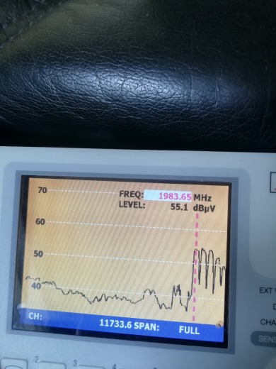

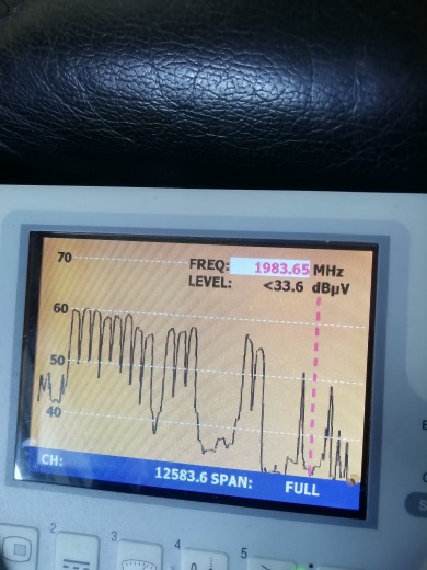

Hello members.
I want to try this signal what you see on the photos with satsagen and sdrplay.
I am already ready to connect satsagen with sdr play. How do I have to set it, seek that I get that image as in the photos.
I hope someone of you can help me in that.
Best regards
Best regards
- IMG_20230819_085712.jpg (54.29 KiB) Viewed 15857 times
- IMG_20230819_085602.jpg (51.74 KiB) Viewed 15857 times

May I ask how to work at SDRPLAY or at Satsagen.radiogareth wrote: ↑Sat Aug 19, 2023 9:56 amhttps://www.sdrplay.com/spectrum-analyser/ will do any 10MHz segment for you.
The programs are all new to me.
Best regards
Re: Real-Time Spectrum Analyser program
I would sugggest looking at the manual https://www.sdrplay.com/docs/RSP-Spectr ... r-V1.1.pdf and for Satsagan google suggested Alberto's videos https://www.youtube.com/watch?v=yjobY6vs4z0
