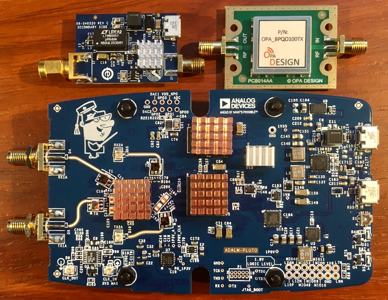

Months later and finding time to play with the Pluto. I need to ask, in which order should the pre-amp and filter be?
Pluto --> CN0417 --> OPA_BPQO100TX --> PA with max i/p 80mw for 100w out.
or
Pluto --> OPA_BPQO100TX --> CN0417 --> PA with max i/p 80mw for 100w out.
For QO-100 DATV, does Pluto have an 'optimum range' of output powers giving acceptable distortion?
Finally, if I needed to insert an attenuator, where would be the best place to place it?
Michael EA7KIR

Post by g4eml » Mon Apr 25, 2022 8:39 am
The CN0417 board already has a 2.4GHz band pass filter on its input so there is no point in having another filter in front of it. The output is unfiltered. Based on this I would fit the filter after the CN0417.
To produce a good DATV signal the Pluto gain needs to be set a little below maximum. About 80% gain seems to be OK.
The Pluto output level already has a good range of adjustment. The only reason for fitting an additional attenuator would be to ensure that each of the following amplifiers is not being driven too hard. The position would depend on where the overdrive was occurring.
Colin G4EML
