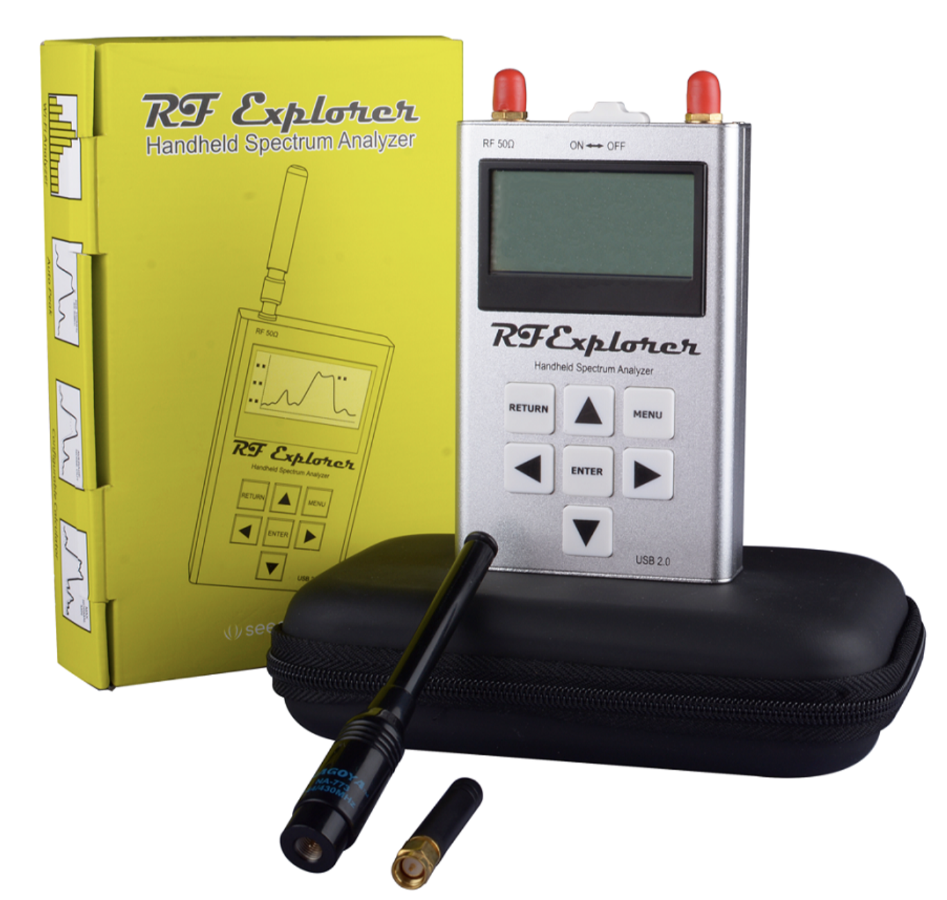

Has anyone tried any of the RF Explorer http://j3.rf-explorer.com spectrum analysers?
I'm wondering if the RF Explorer 4G Combo PLUS would be good enough to look at the 2.4GHz QO-100 uplink, but also for aligning the dish by looking at the LNB output.
