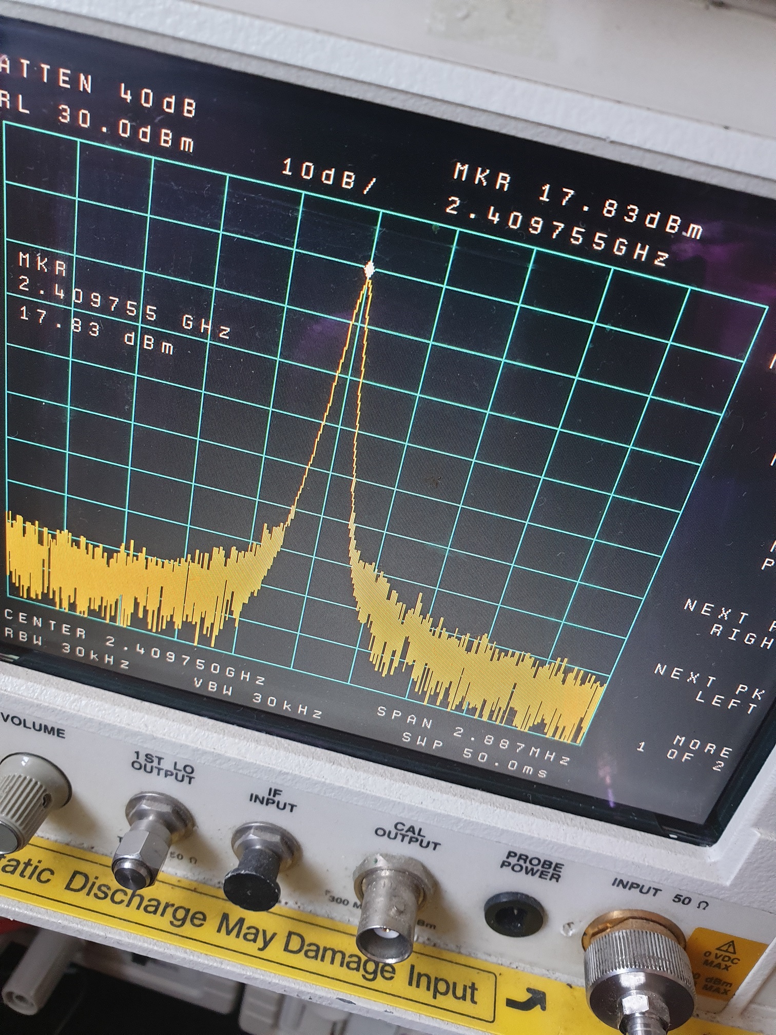

Post by G1BVI » Fri May 13, 2022 6:57 pm
I secured the Nokia Amp to a heat sink 430 x 150
My PD4 is fitted with a lime mini which is fed int AMSAT UK driver amp to give 0dm out.
The Nokia amp is connected to a 28v 25A supply.
I measured the output power at just over 60w.
Verry impressive but it will need a fan to take the heat away,
See image (30db attenuator on output)
