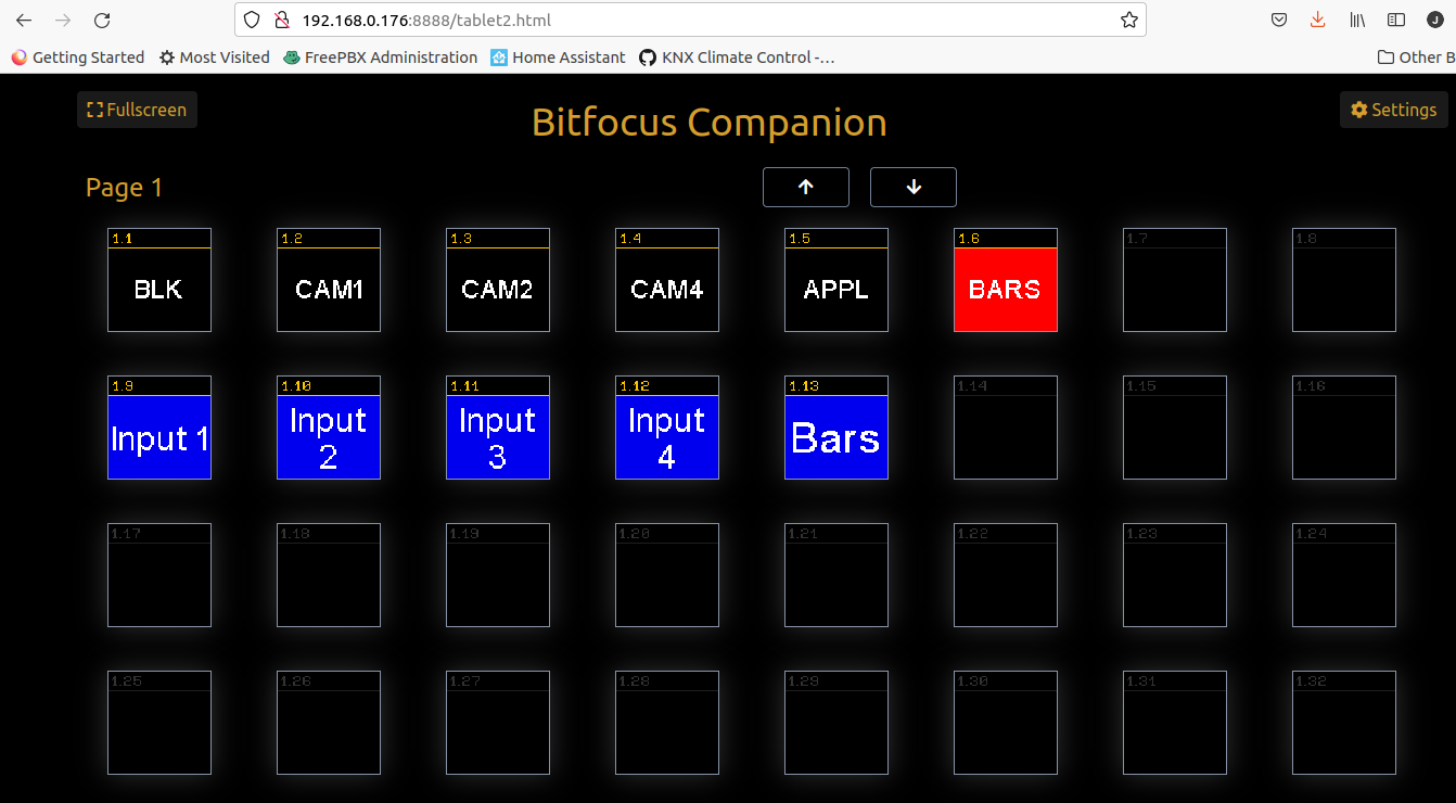

Re: Triggers as an alternative to GPIO
Dave,
many thanks, that's really helpful. What I like the most is that it is virtually all out of the box.
The Bitfocus Companion software looks after all the communications to ATEM, but it can also talk to OBS, BlackMagic Multiview, ATEN Matrix and interfaces to many other devices, making it more-or-less hardware independent. Programming it is very easy indeed, really just configuration. The number of hardware devices that the software can interface with is mind-boggling. The software also runs on Linux/Windows and Mac and there is a Pi port too and new integrations being developed all the time. Using M0GUY's PiDeck brings a very capable media server too that already integrates with the ATEM.
The "trigger" from each receiver would be the "locked" state and the all important "un-trigger" (basically calls the ATEM standing media MACRO) the "unlocked" state I have the POC working now with an http command, for example:
http://192.168.0.176:8888/press/bank/1/13 selects (the reference is just the virtual Elgato StreamDeck button as in the picture) In my picture the first row is switch commands, the second row transition MACROS.
Using the timer function in Companion would bring up graphics images and lower-thirds (.png transparencies from the media player) etc, so that part is easy, the call would be to an ATEM MACRO that can perform the function of the media rotation etc. Remember the ATEM also has the option of a streamer output (and input) and has analogue microphone/line inputs and a built-in still media player that holds 20 pictures or transparencies. It also supports PiP, so if a second input comes up then that can be a PiP.
I had thought of priority management and for that it might be easier with a single server, in fact it had crossed my mind to use your repeater controller for this, but then I thought you can just prioritize on a last-in first out basis to begin with. I doubt it will be a major issue in practice. The back-up would be manual input selection on the web site or by using the PIP function or by sending the web request to the site Atom PC and brokering the priorities there, but there are so many built-in possibilities with the Companion.
One thing for sure, using OBS or ATEM as the switcher has many more future opportunities for creative transitions and inserts than an HDMI switch and that's my main driver as its more future development proof and offers the opportunity for some very creative interfaces, even "super chats" that pop up like an iPhone SMS when someone chats via the BATC web site.

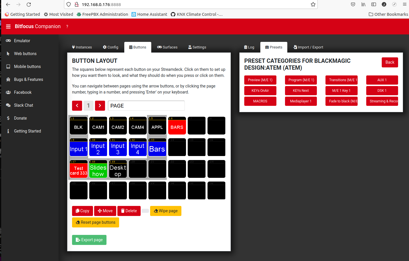

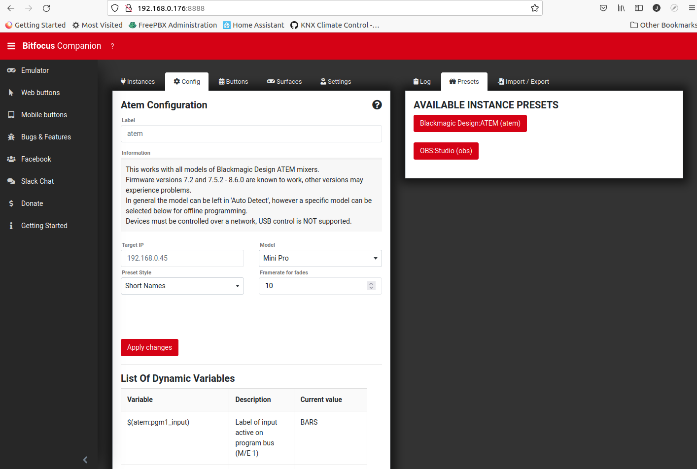

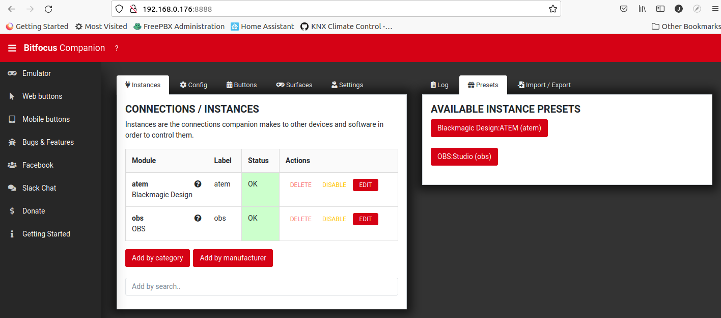

Dave,
The web commands are really easy:
http://192.168.0.176:8888/press/bank/1/9 will select button 1.9 as per the image. In this case it's a MACRO that makes a wipe transition to Input 1 on the ATEM
http://192.168.0.176:8888/press/bank/1/1/6 will select button 1.13 and select a "cut" to color bars in my example image
The actual button function is a configuration in the "Companion" app which is here: https://bitfocus.io/companion/
The basic config is easy:
Install the software on your desired platform (Linux, Windows, Mac)
There is a web server interface on port 8888 or you can use the host machine
You then add your device or "instances" in otherwords the platform
Under "presets" there are actions that you drag to the appropriate button on the "virtual" Elgato StreamDeck (you don't actually need a Streamdeck, but you can add one). You can customize presets and make your own, but for the ATEM world I use ATEM macros, might be a slideshow or the brief display of a lower third graphic.
Of course you could add an "OBS" if you wanted or a presentation switch, Cisco conference bridge, about 240 integrations. I coudl even add my KNX Smart Home as an instance through Home Assistant (I run GB3JV telemetry repeater via ModBus and I built the dashboard in Home Assistant)
I've also added OBS, You need to install the OBS Websocket plug-in, when you connect Companion to OBS it automatically copies your OBS set-up to Companion, so you have per-configured buttons that you can drag and drop onto the virtual StreamDeck instance.
Here is a video showing it: https://youtu.be/57OAIE600G0
If you buy a StreamDeck, you get physical buttons with mini TFT screens that you can put your own Icons onto. In my picture the third row is the OBS instance.
So all I need to implement a repeater controller is the ability to send a web command to the REST API
I've tested with Telnet and Web.

I've started to look at this and I think that it will be practical.
There will be one entry in the config file to set the device address and port, so something like:
Code: Select all
networkctrlurl=http://192.0.1.176:8888Code: Select all
output1netcommand=press/bank/1/9
output2netcommand=press/bank/1/1/6I do not have any triggers for specific inputs dropping, when an input drops it just goes back to the controller image (except for quad which is more complex).
Dave,
Controller working in its basic form
two questions:
Is the position of networkctrlurl=http://192.0.1.176:8888 in the config file critical? Should it be at the top?
Should the switching commands (output1netcommand=press/bank/1/9) replace the IR commands or can they be added as well?
Justin.
