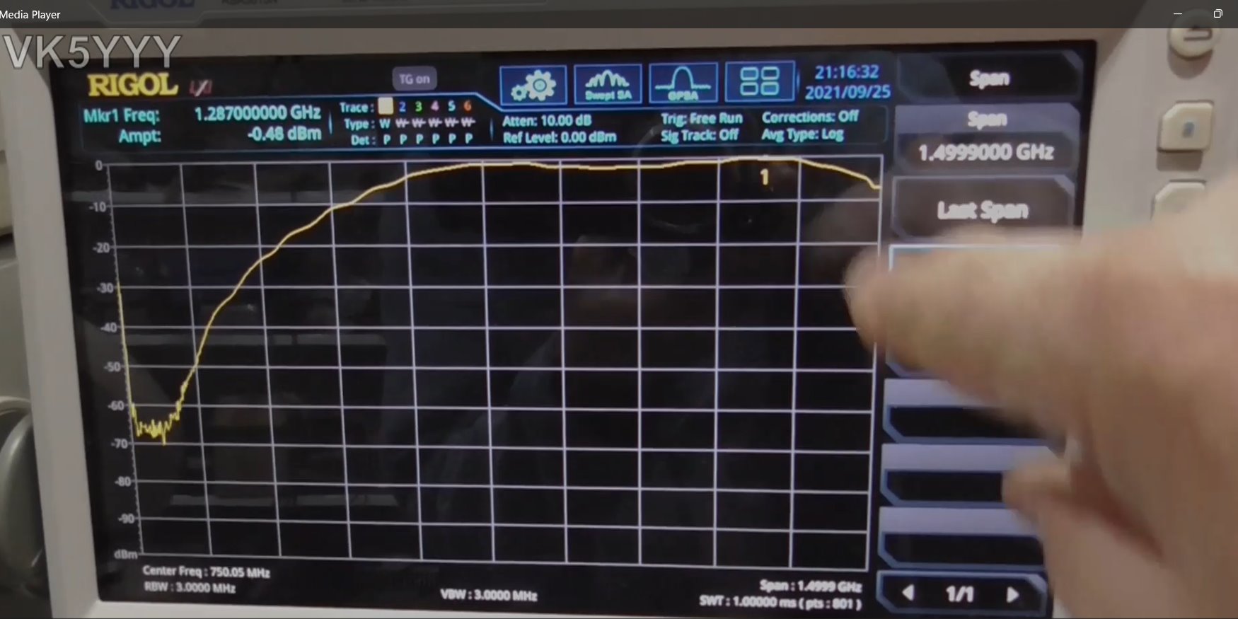

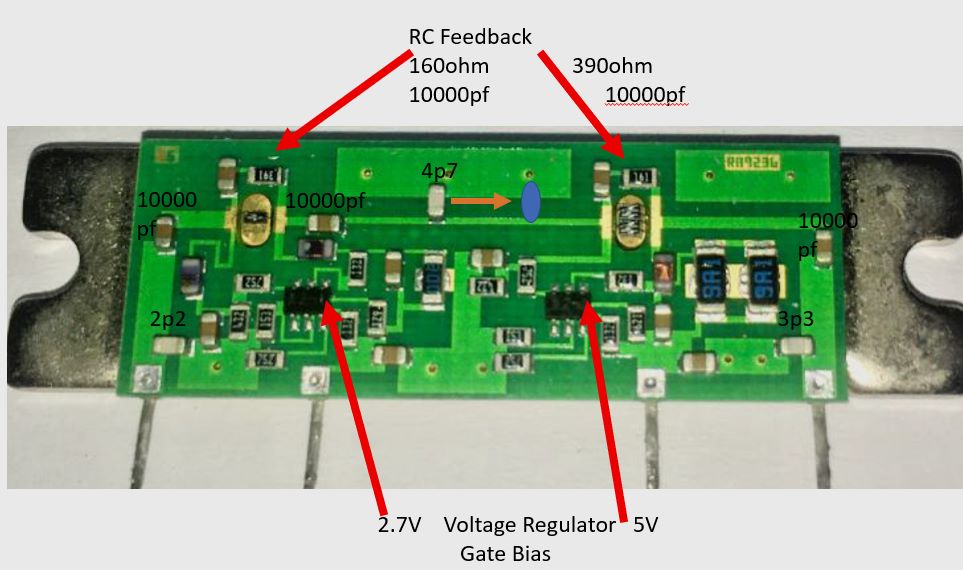

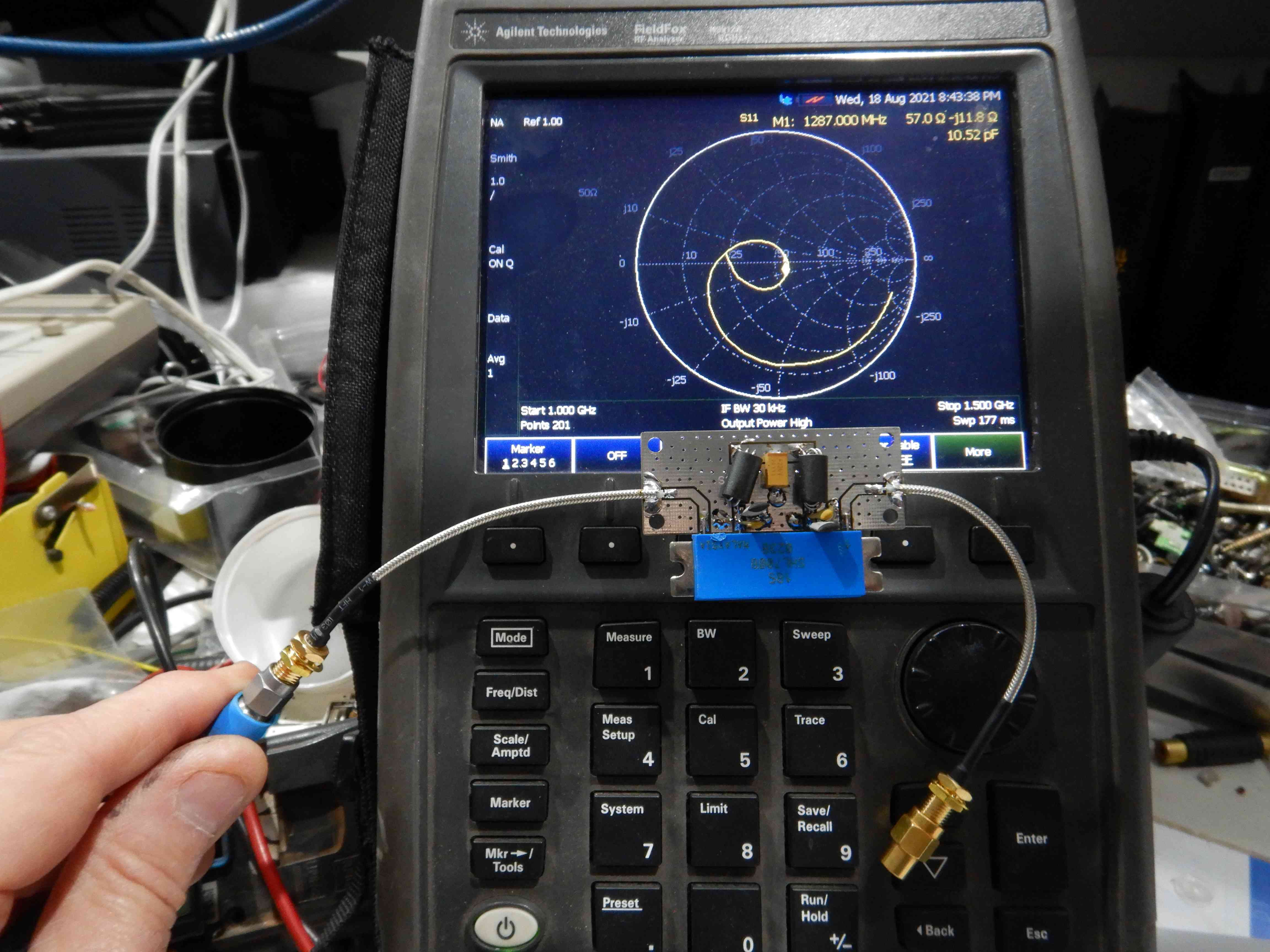

The SHL7008 is 24V, looks pretty much similar except there is 2 gate bias regulators, eBay item number:193754802490
The only mod is moving the cap, in yours it's removed and change out the existing cap to 1-2pf (lower) value
I scrapped the green mask back and moved the 4.7pf cap to the right to achieve best output power
Adjusting the output cap on mine didn't do much, they had 29-32db gain @ 1287mhz

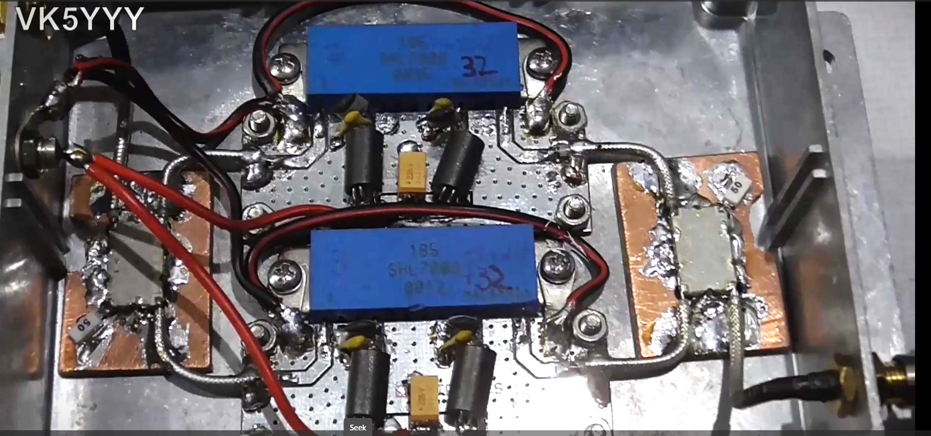

Two modules and couple of Anaren hybrids beefed it up a bit, this also massages in and output match to 50ohms
I gave the dual unit to a guy in VK3 and to my knowledge he is still driving it with a pluto to get into the Melbourne repeater
The response is fairly wide band on these devices, the output match on a single unit looks good on mine (after the mod)
Out of around 7 devices, there were 2 sus ones, I may have mucked up, or the quality was poor, I can be impetuous and careless
It's not a substitue for the Mitshubishi Module, but thought it was ok for around a watt or so on DVB-S or as a driver
Tried driving Jim G7NTG's amp with one to get the power up, but it's still on the bench unfinished
No doubt someone smarter than me can take it to the next level
Cheers Roger VK5YYY
