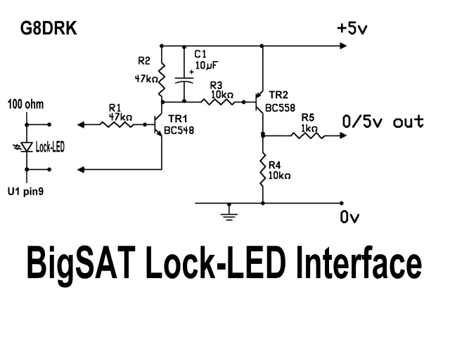

Big Sat 1CR lock detect modifications
Robin G8DRK, keeper for GB3UT sent me the following:
The BigSAT Golden 1CR receiver has a Lock-LED that shares its strobing with the LED display. So to successfully "decode" the Lock-LED status for Repeater-switching purposes, it is necessary to employ a little interface circuit that samples both sides of the Lock-LED and produces a ripple-free output that is referenced to chassis.
You need 2 transistors, TR1 is NPN (BC548 or similar). TR2 is PNP (BC558 or similar). Both types are very uncritical.
You need 5 resistors (2x 47K, 2x 10K, and 1x 1K).
You need 1 capacitor (10uF electrolytic or tant).
You will need to make use of the +5 volt supply - not available on the front panel itself, but present on the card module and main PCB.
________________________________________
Draw out your circuit from the following description:
Connect emitter of TR1 to cathode of the green Lock-LED (that's the end of the green LED nearest to the red power LED).
Connect base of TR1 via a 47K to anode of green Lock-LED (that's the end of the green LED furthest from the red power LED).
Connect collector of TR1 via a second 47K to +5 volt line (+5 volt is available on the card module - it is labelled underneath).
Connect a 10uF capacitor across this second 47K (pos end to the +5 volt line, neg end to TR1 collector).
Connect a 10K from TR1 collector to TR2 base.
Connect TR2 emitter to the +5 volt line.
Connect TR2 collector via another 10K to chassis.
Take your switching volts output from TR2 collector via a 1K.
Output will follow state of Lock-LED (Extinguished = 0 volts, Illuminated = almost 5 volts with no strobe ripple). There are spare pins on the serial port you can use to feed the switching volts out to the world. It can be easily removed (two screws) to allow easier access for soldering to the lower row of pins. I suggest using pin-9 (Ring Indicator) as the output. Pin-5 is already a convenient chassis/ground. There is no appreciable "hang" delay built into the circuit - I prefer to do that operation within the switching unit itself.
If you are removing the card module (to improve micro's ventilation and free some space), then the +5 volts line can be found on LH pin of its socket on main PCB (viewed from above, front), also on the LH connection of Q3 in front of that socket, and on R13 (not fitted) close by - take your pick. On my receiver the 5 volt rail was somewhat low at 4.77 volts, but that just affects the maximum output available.
