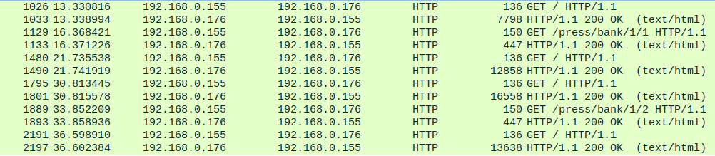

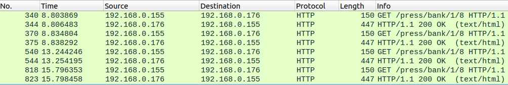

I've done some more testing this morning and discovered a bug in the switching. I've attached the config file and wire-shark captures for reference.
I'm testing by simulating switching of GPIO pins #32 and #35.
- Whichever input I select on the GPIO the controller outputs the same command to switch to the controller input #0 output0netcommand=/press/bank/1/8
Packet Capture with output0netcommand=/press/bank/1/8 set
Packet Capture 2.png (49.73 KiB) Viewed 24922 times
I modified the config file to remove the line in the input0name=Controller configuration:
#output0netcommand=/press/bank/1/8
After this the correct commands were sent when the input went high, but no command was sent to the controller when the GPIO input went low again after my simulated transmission.
Packet capture output0netcommand=/press/bank/1/8 commented out
Packet Capture 3.png (59.45 KiB) Viewed 24922 times
Expected behavior is that that following transmission the command output0netcommand=/press/bank/1/8 would be sent to return the source back to the controller input.

Re: BATC ATV Repeater - Network Control of Video Switches
Post by G8GKQ » Sun Feb 27, 2022 2:37 pm
Hi Justin
Pleased that the basic control is working.
Working through your issues, I can't see anything that is not intended or known behaviour. I think that it will become more clear to you when you use proper switching and have multiple sources connected.
  • I did say that to enable the new functionality you would need to reject the option to keep your old configuration file.
  • Each parameter can only be set in the config file once.
  • There is a bug where the Raspberry Pi will hang (unresponsive) for 90 seconds before rebooting when commanded. This is to do with the GPIO driver and I have been unable to find a reliable cure. I would be interested to hear if the restart hang lasts longer than about 100 seconds. This bug would not affect the Ryde - it uses a different GPIO driver.
  • When an input is detected as active, the first thing that happens is the video switch is set to the controller to show the "announce" caption. If this is not required, you can set the input1announcemediaduration=3 parameter to 0 for each input. Then the repeater will switch directly to active inputs.
  • You can monitor the commands being sent over http by starting the controller from the command line. You should see something like this when selecting an input:
    Code: Select all
    Switch change detected, checking for debounce
    Input Status - 1: 1, 2: 0, 3: 0, 4: 0, 5: 0, 6: 0,
    previous decision result is 0, entering decision process
    Setting inputActiveInitialState 1: 1, 2: 0, 3: 0, 4: 0, 5: 0, 6: 0, 7: 0,
    Priority 1: ----- priority_test = 1,i = 1, inputactive[i] = 1
    After process, decision was 1
    Input status change.  Current Output = 0, New Output = 1
    Entered Switchto for output 1
    Carousel Scene 2 displayed
    HDMI Switch input 0 requested
    -curl http://192.0.1.176:8888/press/bank/1/8 &-
    HDMI Switch input 1 requested
    -curl http://192.0.1.176:8888/press/bank/1/1 &-
    inputChangeDuringAnnounce = 0
  • There is debounce on the "input active" inputs. I think that it is adequate for receiver-switched inputs; it is not designed for toggle switches!
G8YTZ
Posts: 107
Post by G8YTZ » Sun Feb 27, 2022 5:55 pm
Dave,
Thanks & understood. I was too quick with my switching! Yes, it works perfectly. I'll disable the "announce" function as the ATEM macro can do this as transparencies with the Downstream Keyer.
I saw the RPI bug again, as you say it does reboot after 90 seconds or so, again I was not patient enough.
Thanks for the tip on monitoring the live traffic.
or Ethernet Switching the Brianboxes SW05 Industrial switch makes a lot of sense. It can run off 5-30V Made in GB too. :-)
One last question, is it possible that the ident audio can appear on the analogue audio output as well as HDMI or is it either/or?
Justin.
