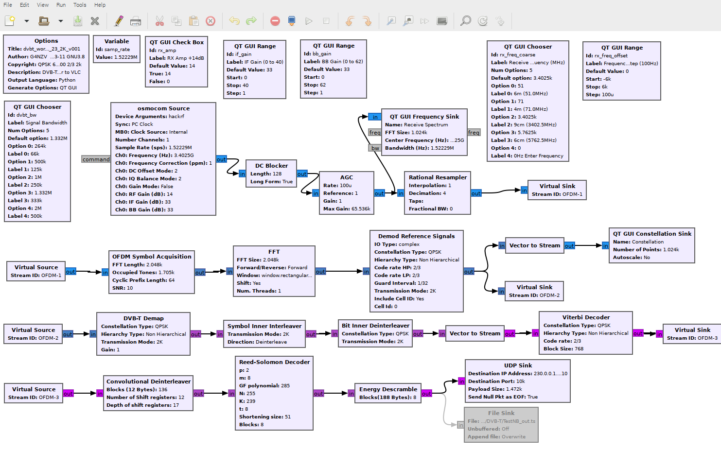

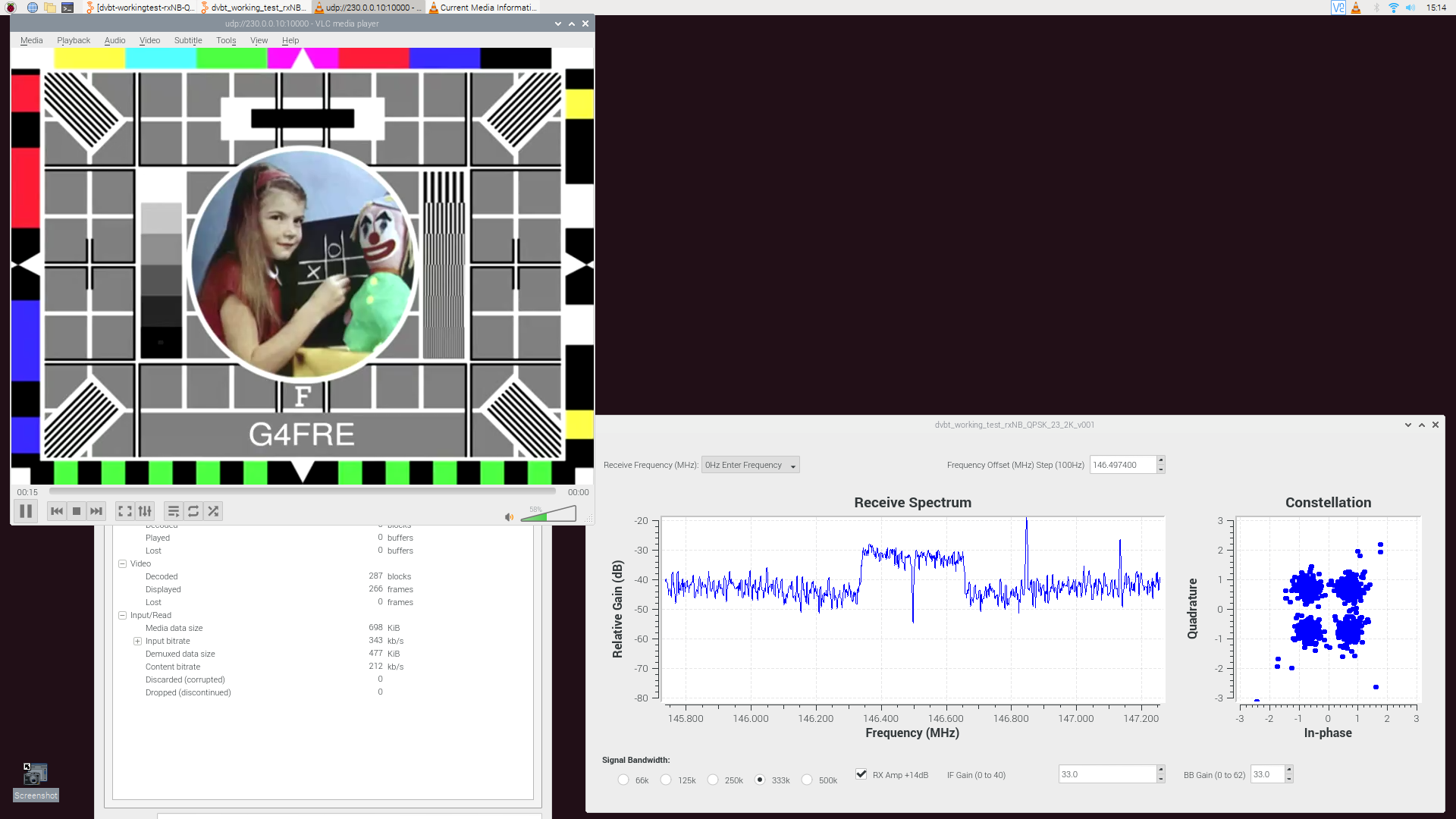

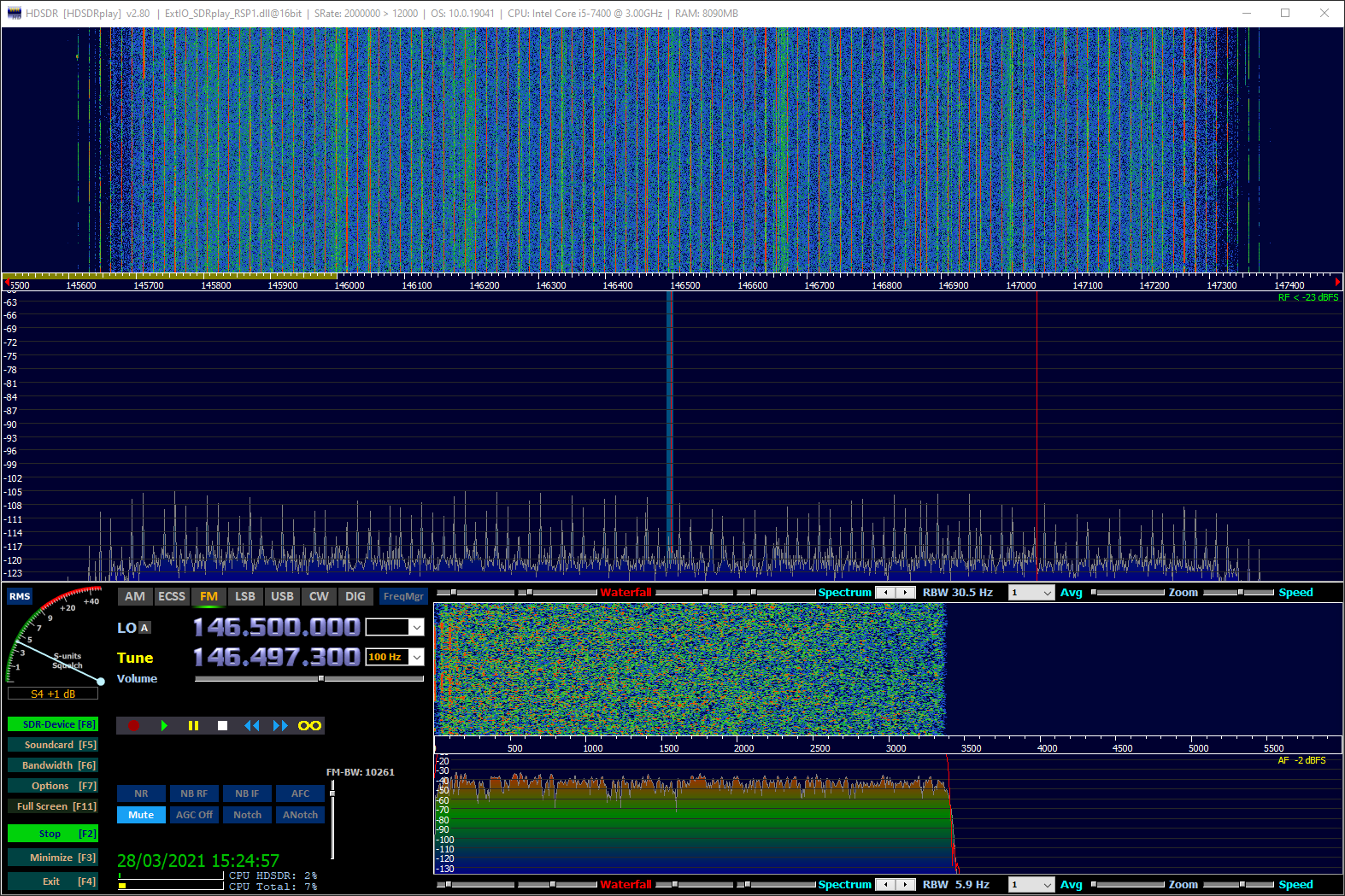

Main objective of these tests is to gain experience of a Portsdown4 Narrowband DVB-T transmission on 146.5MHz over a 17.5Km path and to undertake on-air testing of a homebrew GNU NBTV demodulator and a Knucker. The outcome was video and audio transmissions were received in both directions.
G4NZV Transmit setup: C920 camera + Portsdown4 + Pluto (Fitted with high stability TCXO) + Driver amp + Band Pass Filter + Power Amplifier (5W) + 9 element horizontal yagi
G4NZV Receive setup: 9 element yagi + Pre-amp + Band Pass Filter + HackRFOne + Raspberry Pi4 + GRC DVBT NB software demodulator + VLC + HDMI monitor
DVB-T setup on Portsdown4: DVB-T + 146.5MHz + Bandwidth 333KHz + FEC 2/3 + Guard band 1/32 + Mode 2K + Pluto Power 0
Lessons Identified:
- Software demodulator needs to be tuned to within +/-0.5% of the centre carrier frequency for successful demodulation.
- Occasionally a centre spike was observed on the received spectrum which was used to tune the receiver to the exact frequency of the transmission (in this case 146.497400MHz).
- During reception interference across the band appeared, however demodulation continued. This shows the resilience of OFDM to an interfering comb of frequencies. (see attached images).
- Coding and decoding delays total around 3 seconds which makes for an enjoyable QSO.
- The video is much smoother and the demodulator lock time is almost instant if tuned to the centre of the transmission.
- Lip sync is excellent.
- There is a tendency for VLC to lose lock and need restarting even though the demodulator looks as if it is working.
- Rapidly changing images (e.g. swinging the camera around the shack) can cause problems with the system, it was not possible to determine if that was caused on transmit, receive or both.
- The received SNR was 12dB (about the same level as the interference). When shack testing with no interference the demodulator remains locked with an SNR of 8dB.
Inspiration for the software DVB-T demodulator came from: HB9DUG, F4FDW, github gr-dvbt
Thank you to G4FRE for giving up his Sunday afternoon.
Steve G4NZV

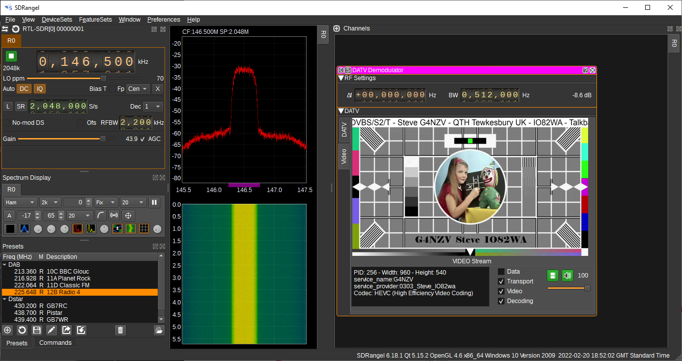

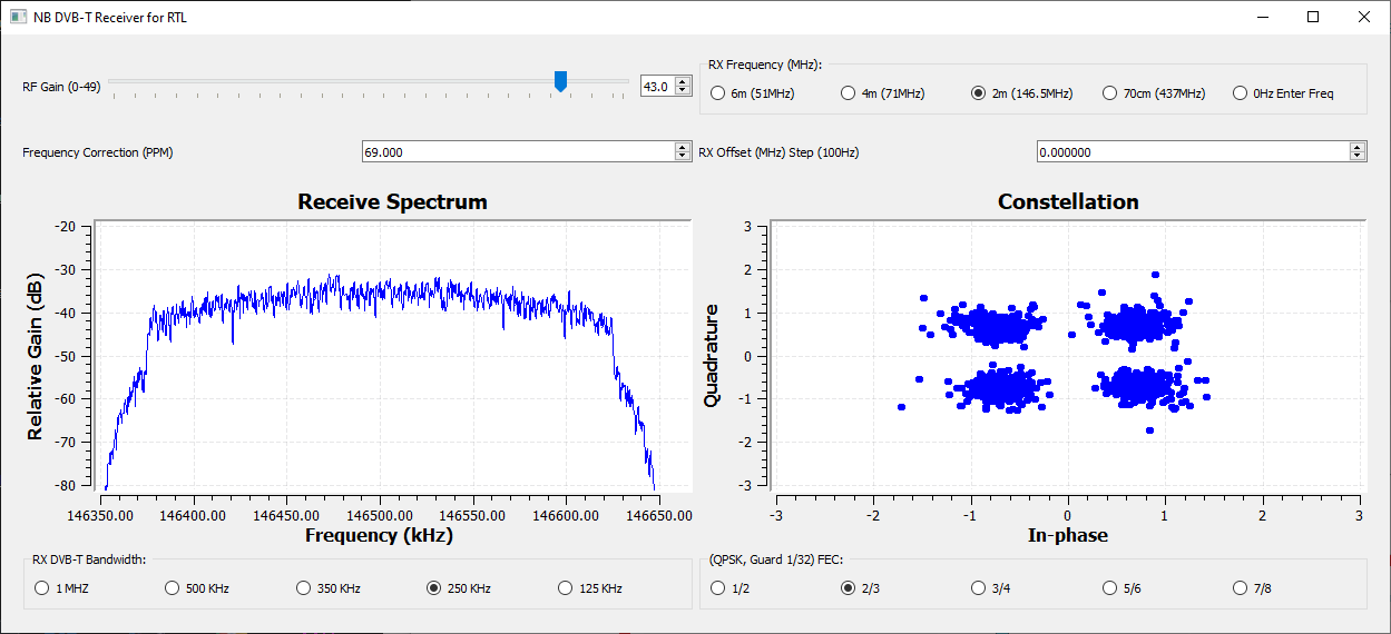

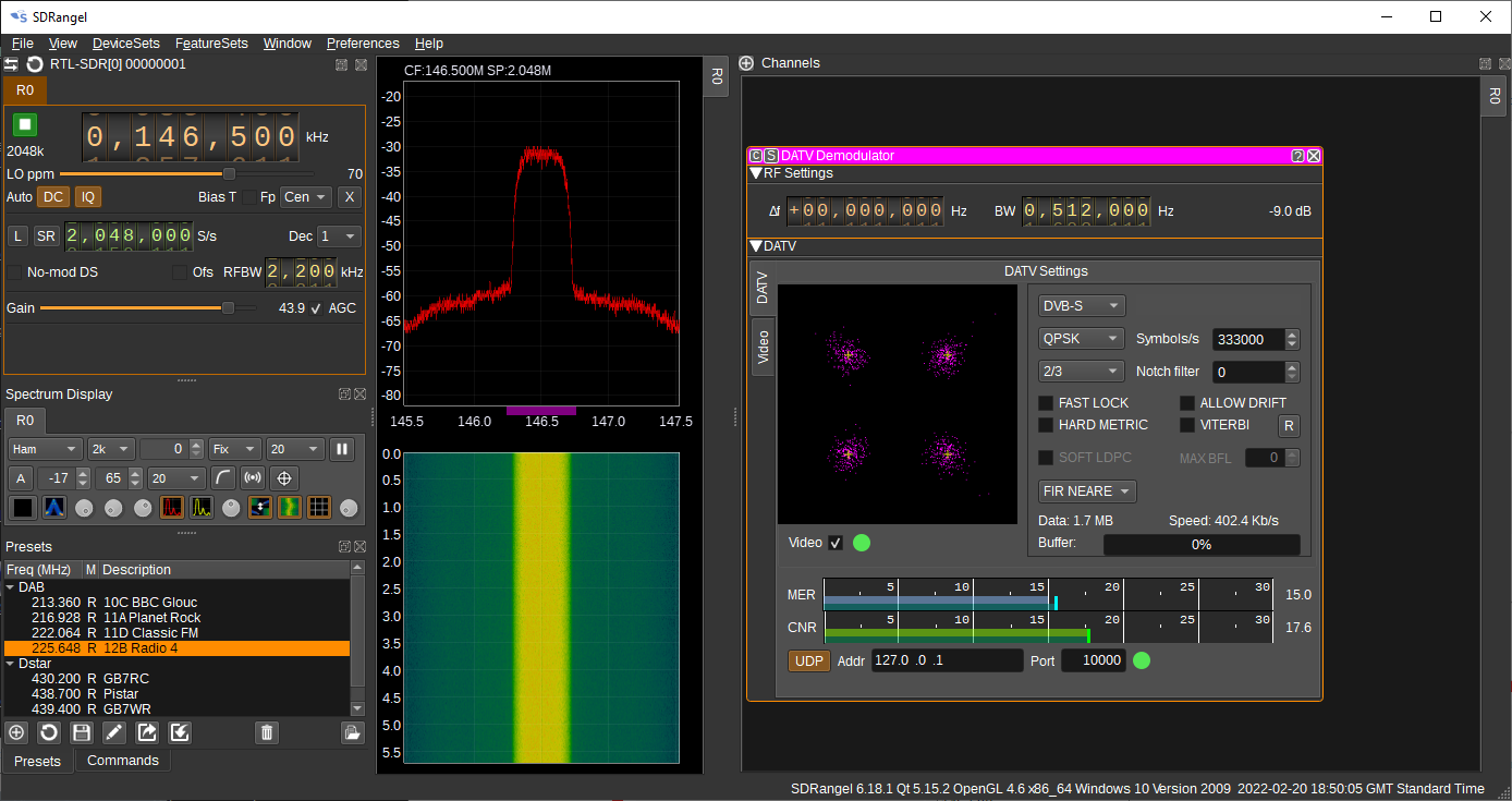

I am making assumptions about the hardware available however here goes for some options to decode some reduced bandwidth DATV signals.
To decode DVBT or DVBS using a RTL820 and a windows 10 PC. For DVBS use SDRangel (there is an option in the menu for DVBS2 however I have found it extremely unreliable). Two screenshots show how to setup SDRangel to decode DVBS using a RTL dongle. SDRangel can be downloaded from: https://github.com/f4exb/sdrangel/releases
To decode DVBS2 reliably a minituner is required along with the minituner software or a Ryde receiver or Portsdown 4.
To decode reduced DVBT a knucker and a Ryde receiver will work except at a bandwidth of 125KHz. An alternative is to use GNU radio version 3.9.5 and Radioconda on a windows 10 PC. Incidentally GNU3.9.5 can also be installed with the PiSDR package on a Pi4.(see my previous post to install and setup). I am happy to share the gnu .grc and python .py files for use DVBT with a RTL820 plus how to use. (Just waiting for guidance from Dave G8GKQ on where to place them on BATC for download.) I have attached a screenshot of DVBT being decoded. VLC is used to display live video and audio.
I am sure there are many other alternatives however these work for me.
73 Steve G4NZV
