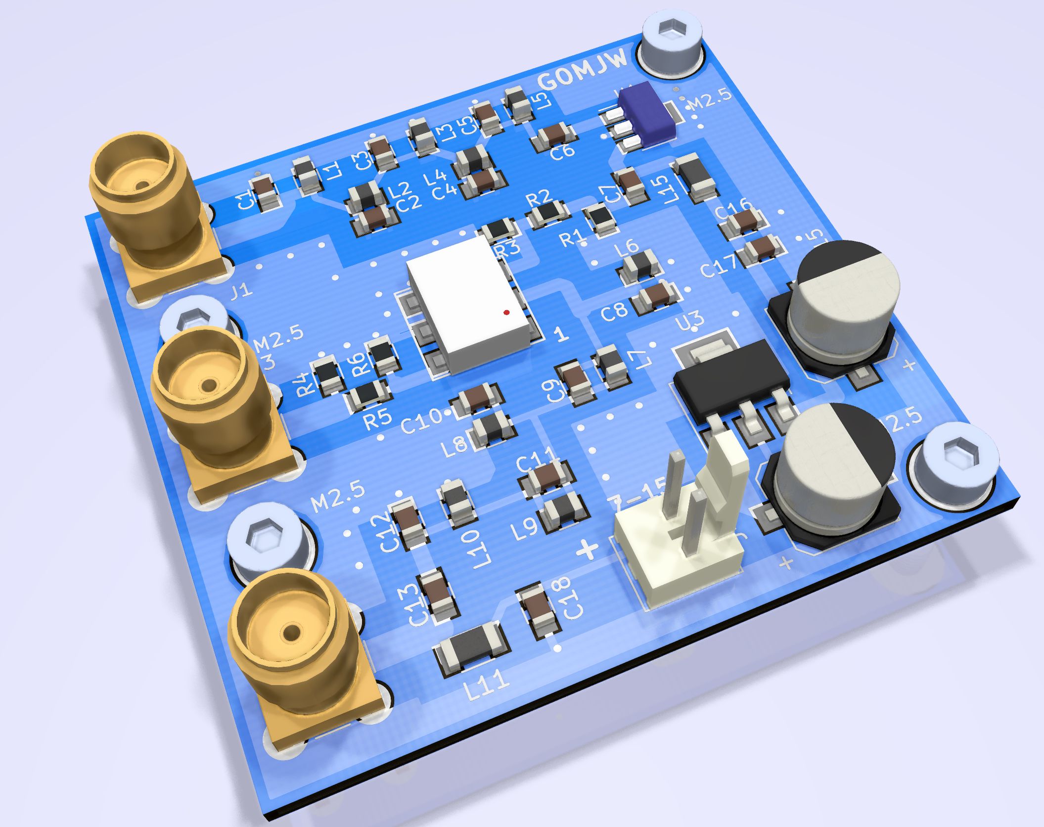

Post by g0mjw » Thu Nov 09, 2017 11:41 am
I'm just working on this. Just an exercise leveraging the $5 for 10 PCBs offer from PCBway.
Mixer Board 2.jpg (339.19 KiB) Viewed 28267 times
The minitiouner will not, as far as I know tune down to 71MHz. Plan is to up-convert to a higher frequency that the minitiouner can cope with better. It uses an ADE11+ mixer and a PGA103+ to provide some amplification if needed. I have added lots of pads to the board to allow flexible use with different filter designs e.g. low pass, high pass, band pass, band stop, all pass, no pass which would allow it to be used as a down-converter, a filtered preamp etc. Good RF design principles have largely been ignored so it's not going to work at very high frequencies.
The LO +7dBm comes from whatever, e.g. the ADF4351 as used in the Portsdown, or an SI571.
Is anyone else interested in this sort of thing or is it just me?

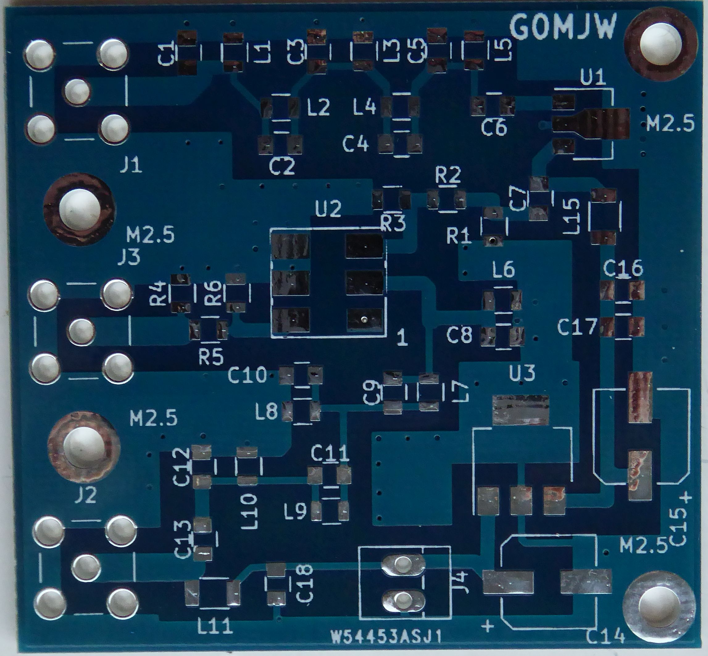

Posts: 2742
Re: 70.5 - 71.5 MHz
Post by g0mjw » Thu Nov 23, 2017 8:16 am
The test boards have arrived from PCBway earlier than expected. Not bad for $16 shipped. The vias are so well implemented I had to use a torch to check there really were holes there. The silk screen looks good. The jury will be out on the design until I get all the parts together. I have already made some improvements to the board design. Even thought about putting the LO on-board using one of those 400MHz LVDS chips, but it's probably best and more flexible left as it is.
Mixer PCB.jpg (506.63 KiB) Viewed 28053 times
