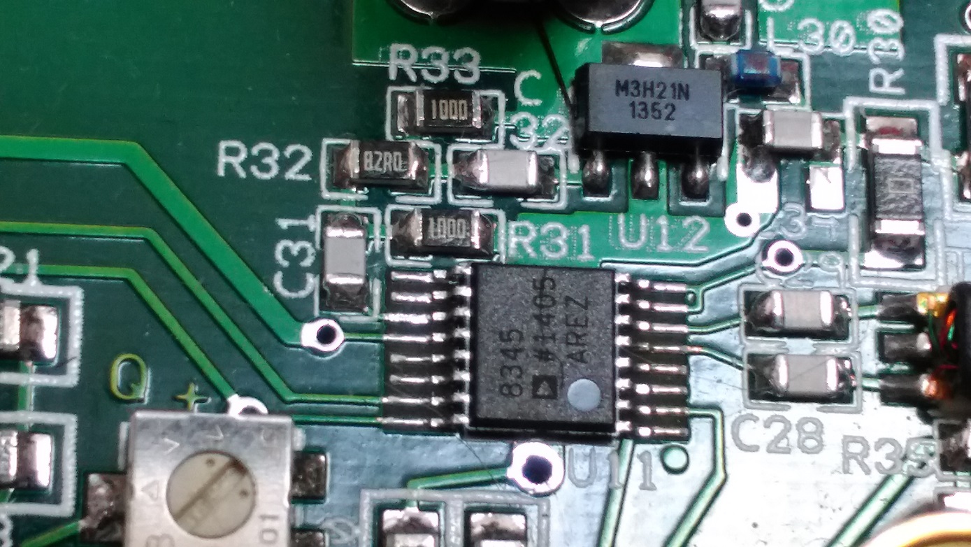

Digikey did well so I have the parts and decided to have a go this morning. I have all the parts in except the modulator. That one looks a little daunting. How do you fit it without an oven?
G4KLB
Posts: 252
Re: RBTVMOD
Post by G4KLB » Sun May 01, 2016 11:48 pm
It is the same modulator as the 70cm Digilite, so you should get some advice on here.
I lightly tin the pad on the underside of the AD8345, removing most of the solder, too much solder and the pins will be too far of the PCB
I use a flux pen and 26swg solder. Flux the pads, position the device, solder one of the outer pins and check its aligned correctly, (plenty of light and a good magnifier needed here) solder the rest of the pins. You may short out some pins with too much solder, remove any excess with solder wick.
When you have the correct amount of solder, add plenty of flux again and even with a fairly large clean iron tip you wont have any shorts.(even if you bridge two pins at once) I do this fairly quickly sliding the iron away from the device.
Turn the board over and heat up the ground pads, feed a small amount of solder in the via if you want, do this quickly, as its possible to unsolder the other pins at the same time.
Inspect closely and clean off the flux residue. (I use IPA for that)
Its not as difficult as it looks. :D
Having said all that, the prototype DigiLite's used an AD8345 without the pad under the device connected at all, and was never a problem.
