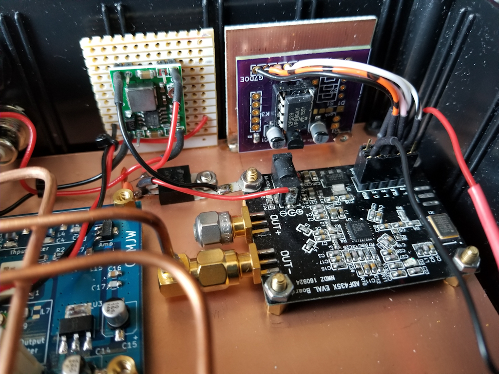

Working on getting get 70MHz rx converter board running. Not that we have 71MHz available in PA-land but for a short RB-DATV test with low power the 70.0-70.5 allocation "has to make do". Just not during Es of course HI.
In the scope of that: the description of the converter board talks about 7dBm "at the mixer". ADF4351 datasheet gives me a max of 5dBm. So... ehh?
While measuring here I find myself looking at something like 0dBm (give or take) out of the Chinese ADF board. Which makes me go even more "ehh...?"
Any suggestions please?

Post by G8GKQ » Thu Mar 14, 2019 11:56 am
Wilko
The ADF4351 will give 5 dBm on an Analog Devices evaluation board, but only 0 dBm or less on a Chinese board.
The converter board will still work with 0 dBm, but the converted signals will be at a lower level.

Hi Wilko,
My converter uses an onboard ADF4350 400MHz oscillator. I used one of the boards from the BATC shop to set the oscillator frequency.
https://batc.org.uk/shop/adf435x-pic-co ... blank-pcb/
You can adjust the ADF4350 output level when you program the PIC; max output is +5dBm and the mixer works fine at that setting.

My upconverter is in CQ-TV 267
Its a modified nooelec ham-it up with built in LO
