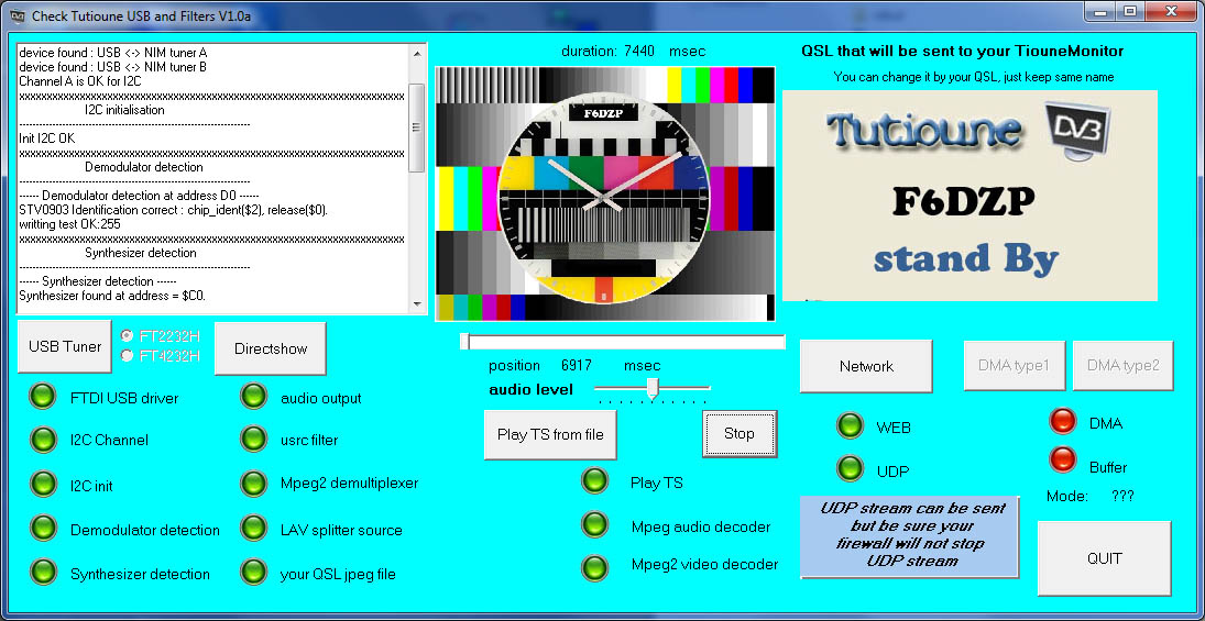

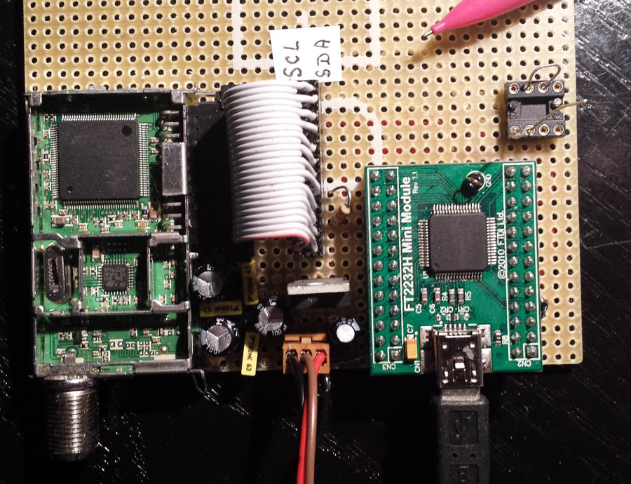

I have a new solution: look athttp://www.batc.org.uk/forum/viewtopic.php?f=15&t=4102
Jean Pierre F6DZP
