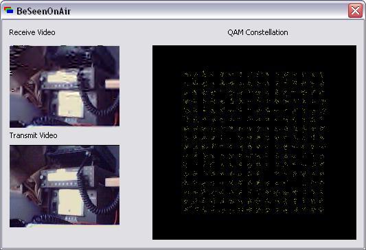

The modem he mentions of mine was a sound card based V.32 modem and I was able to
achieve about 12 kbits on a standard 9k6 radio. I also used the BBCs open source video
codec called Dirac (named after Paul Dirac). To send about 4 frames per sec video.
For audio I used the Speex codec, the world has moved on a long way since I did this
work about 14 years ago.
Although it worked, using off the shelf Amateur Radios of the time it was a bit of a
dead end. Unfortunately there is no way to avoid Shannon's law so you might be able
to cram a lot of data into a small space but there is a penalty you have to pay.
My modem did not use blind equalisation but instead inserted training symbols into
the waveform and used decision feedback equalisation using a gradient algorithm.
You may find this video interesting http://www.youtube.com/watch?v=HVFFq44UvLA
FWIW Here is a screen shot of the program
- Charles
