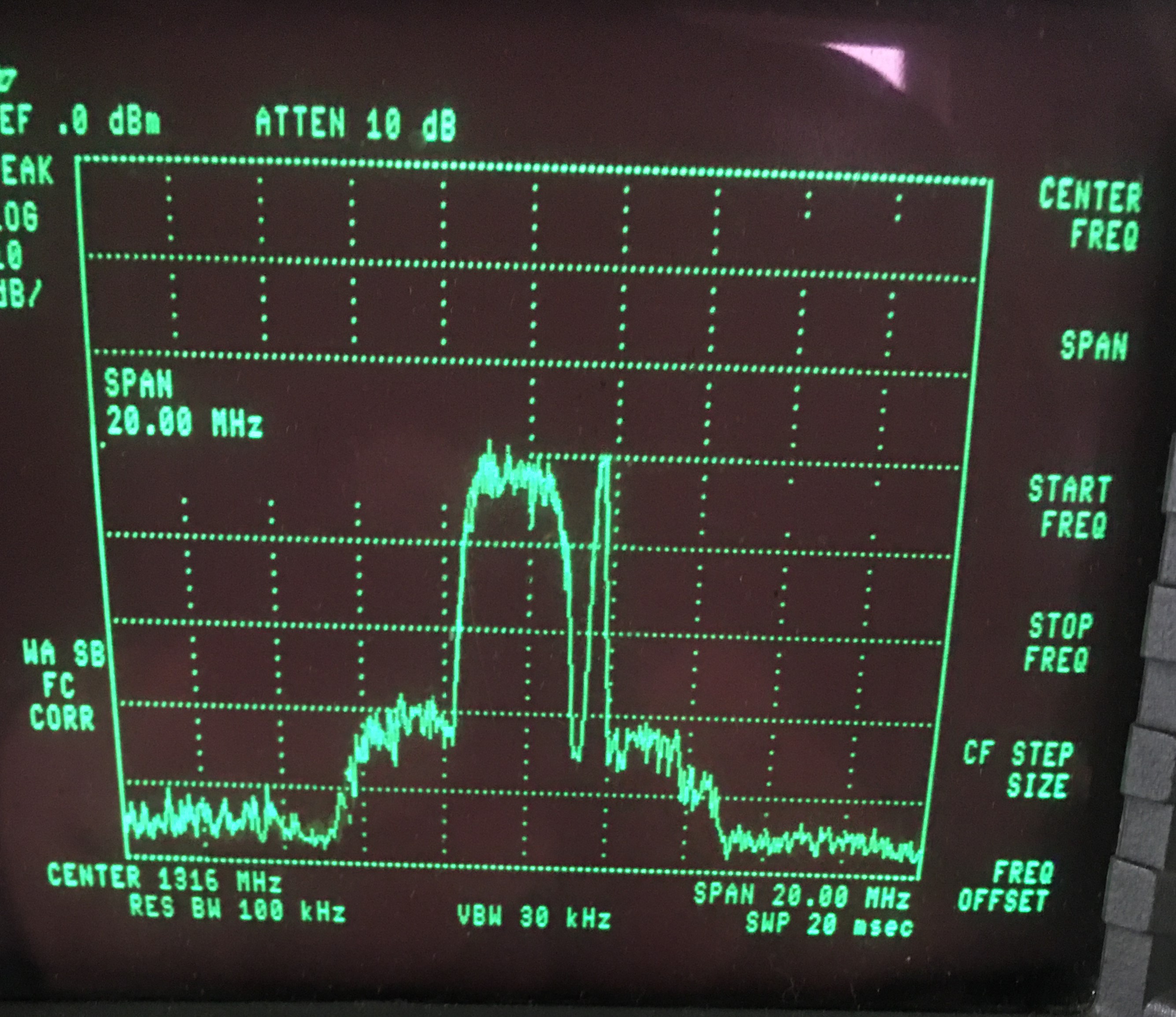

Here in Cornwall we are about to do just that!
We have a 1080 HD service at 2Msym/s which if you can receive it is a superb service however there are areas where it does not cover so we will be installing a 2nd channel 2MHz up from the main output using a 2nd Adalm Pluto at 250Ksym then on to a mixer.
We did tests last summer on this with perfect results see attached

There are several things that we will find out by having two channels on GB3NQ. We already know it works due to the test last year. We don't know for sure if it will make the repeater able to be received further away using the lower symbol rate channel. Can the power output of each channel be considered independantly? in which case the narrow channel could be stronger in that case the reaction between the signals may change. Then there is the type of encoding to experiment with - at the moment it will be H265.
In the future could there be a third channel with just data?

Interesting Q.
I have installed a pluto dvb output next to an analog FMATV signal witch looks like an audio channel.
I do see some mixed signals out of the amplifier but both main signals work great.
I found smaller signals (250 and lower) are more interfered by windgenerators causing more flutter on 23cm.
So i will do some testing with higher Stream resolution to check if the flutter will reduce to a stable picture on 1000 or 2000Ks...
