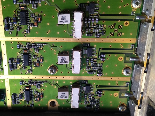

Having looked at the conversion it crossed my mind that each Nokia Dolphin amp has 3 identical input strips which may well tune to the 3XXMHz frequencies mentioned and already have a mixer on each one (wrong place I expect). The wonderful world of surplus......
2020-07-02 12.54.52.jpg (169.91 KiB) Viewed 20653 times
