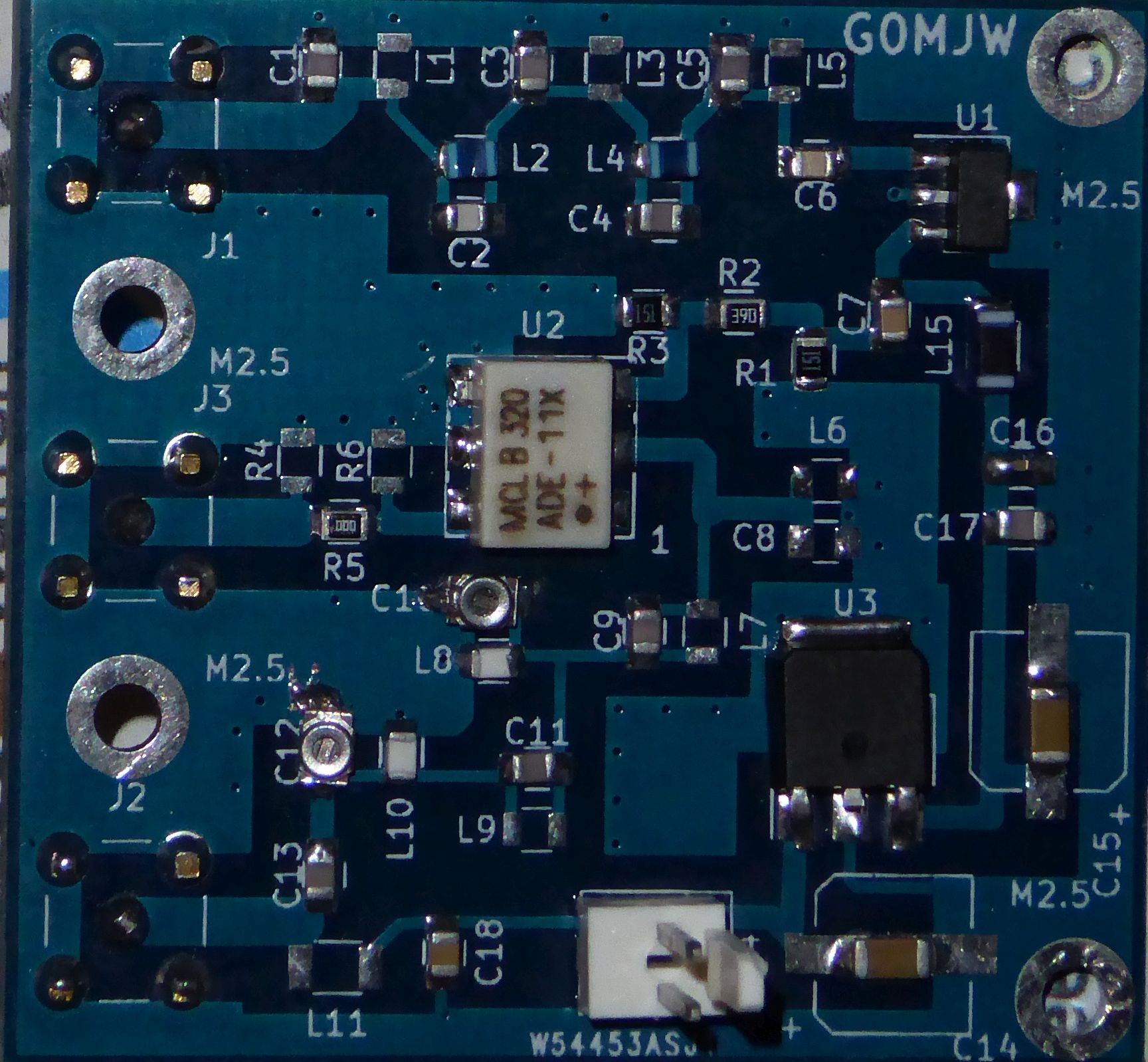

My receiver PCB (Noel has one now and is patiently waiting for me to send him the schematic) requires a 400MHz LO.
Plan is to use the spare output from the Portsdown in CW mode. It filters 50-70MHz, amplifies and converts it to 450 - 470MHz for input to the Minitiouner. There are many different ways you could use the board - no requirement to stick with it's intended use. For a TX converter for example. It can't make tea.

I see - so we either need a RX/TX frequency converter or another modulator. My current board will do that but only if the active device is bypassed to make it bi-directional. Then there would be a need for additional gain to overcome the ~10dB losses mostly important for the RX side. Maybe easier to use two boards one passive for TX, one active for RX. Or I could re-design I suppose but based on the level of interest so far I doubt there is any demand. The Pluto and Lime can do 50MHz and both are about to re breadily available again.

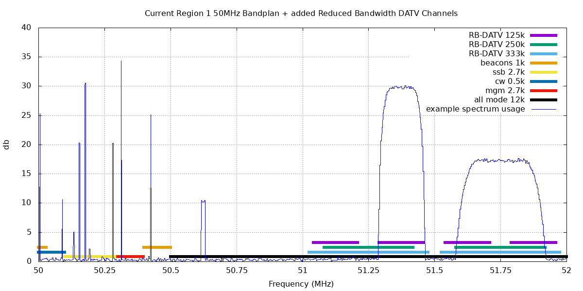

I am qrv on 6m datv. Setup: portsdown tx + minilimesdr + filter + pa output 30 watts into 5 element 1 wl yagi 6m agl. When condx are good I am happy to make a sked. I am experimenting now with some local stations.
I have peaked the yagi to the upper 6m band. Using mainly 51.750 MHz or 51.250 MHz. Attached a file with "the bandplan" we use.

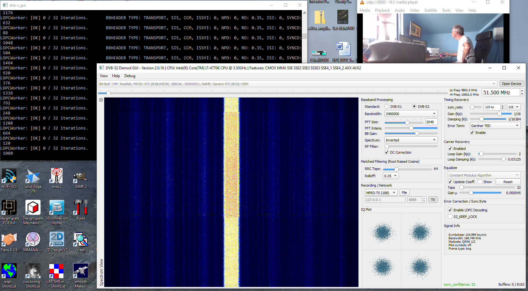

It would seem that TX is 'simple' by using a Lime Mini/LimeSDR.
Rx can be via DVBS2GUI using a RTL dongle, RSPxx or 'another lime' (Pluto does not 'properly' receive below 70MHz).
Just tried it across the shack, works fine. Just need an amp now....
At 125kS even a lowly Intel Atom tablet PC at 1.75GHz can cope at about 60% CPU.
Gareth G4XAT
***Edit*** Just fed it to my broadband HF/VHF amp and get +30dBm of nice clean signal. Now looking for the next PA with adequate linearity (MRF101 design looks promising....https://sites.google.com/site/rfpowerto ... xp-mrf-101 and I have a few spare PCBs for this design too.
