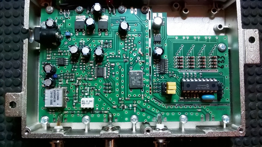

Post by G8DKC » Sun Apr 12, 2015 8:22 am

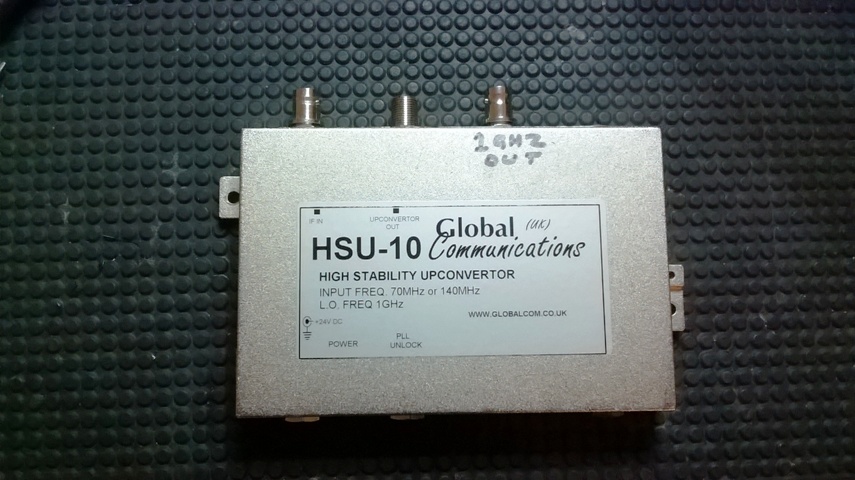

The HSU-10 comes on the market from time to time, stripped from a MTM400 MPEG transport stream monitor,
the un-stripped version going for quite a few pounds! The HSU-10 is not cheap, and does vary in price.
Being used by some to up convert from 146.5 and now 70 Mhz, to Sat Rx frequencies,
and as it is a stand alone mixer perhaps you can go the other way as well to TX?
Update... having just written the piece, I popped on the 437Mhz Tx and yes that's fine as well,
the " 70Mhz or 140Mhz" on the box is what it was made for, not what it can do! :D
Will need a good pre-amp / amplifier for each frequency, filtering etc.
The local oscillator is stable, as they say on the box, but to keep on frequency you can screw in a bnc socket (hole provided) and by moving or "switching?" a capacitor provide a external 10 Mhz source, there is a LMX2325 to produce the 1Ghz L.O being programmed by a PIC16F48, plus some sort of "diode matrix?" into Pic.
A circuit diagram may give the device far more potential :)
I have added a bnc socket to another blanked threaded hole to bring out the 1Ghz and solderd to pcb pad (no mods needed) for monitoring and external projects.
The device is marked at 24v power input, there are 2 onboard regulators at 5v and 12v, testing it looks happy at 13.8v, but to be safe 14v up to its marked 24v supply voltage.
Peter

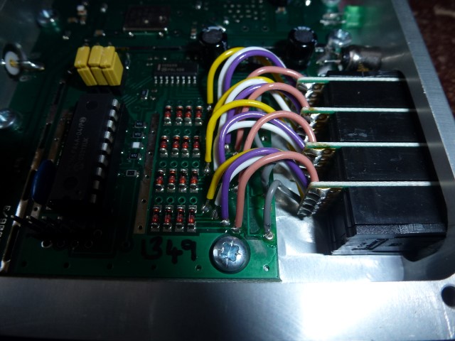

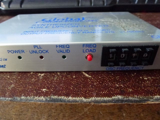

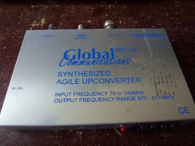

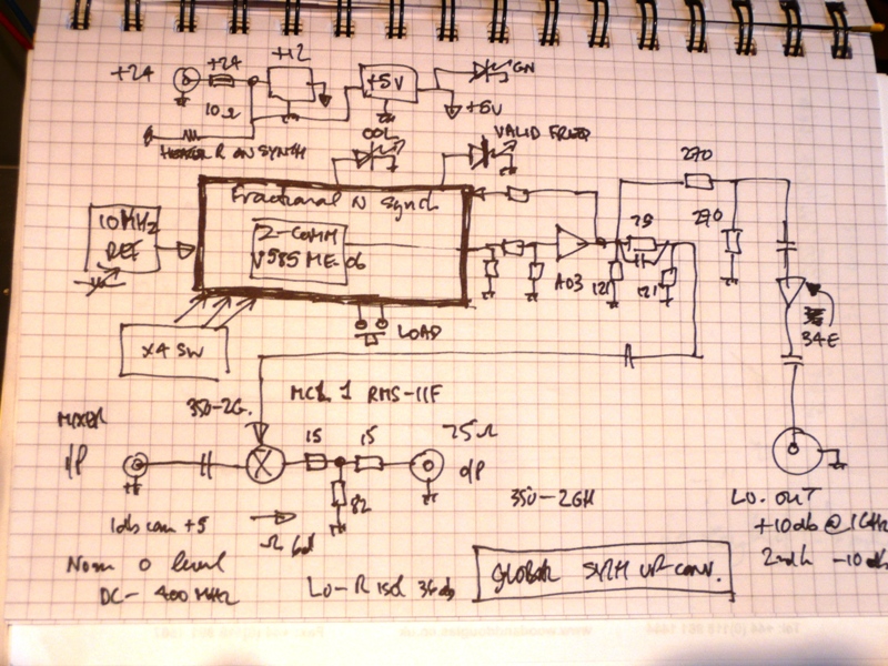

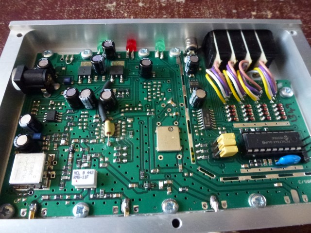

Very useful unit but there is another variant around with a variable LO with output from 970 to 2170 that you may be interested in - I've attached a few pictures and a block diagram drawn up by Peter G3PYB - I reckon it may be worth trying a mod on yours to see if it can be made tuneable :-)
