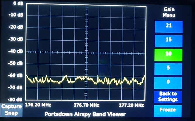

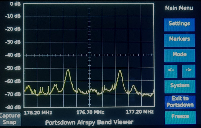

My Rx Spectrum below, this is after phase/amplitude cancellation of a lot of noise!
The two peaks along with many smaller ones wander about +/-50KHz.
I have to improve the noise gathering antenna a bit yet........

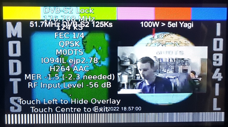

UPDATE!!
An hour later and a better 'noise reference' antenna i have reduced the QRM a lot!
Spectrum vs Rx with 125Ks test signal.
This should be sensitive enough now:
