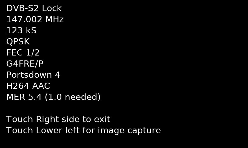

Not sure why the P'down screen grab OSD is so fuzzy??

The Portsdown screengrab is fuzzy because at 125 kS, FEC 1/2, the TS bitrate is only 123607 bits/sec which leaves only 80915 bits/sec for video after deducting overheads and the encoding saftey margin.
To get reasonable moving pictures at that bitrate using the RPi H264 encoder (this is FSTV, not SSTV, after all), the image size is reduced to 160x120 pixels.
On receive, VLC scales that up by 4 to 640x480 using a fuzzy algorithm.
Bet you wished you'd never asked!

No, obviously I understand about the transmitted video issues but wondered why the OSD, which is generated by Portsdown / LongMynd locally was particularly fuzzy?
I wondered if something had a momentary blip as it is also centred on screen - but I can't remember if that is normal...
The OSD on 333ks never seems degraded and I actually got a screengrab of Dave at 125 before the video decoded and that was sharp.

Once VLC starts, the OSD graphics are generated by VLC (based on text that is fed to it from Portsdown/LongMynd), at the same resolution as the incoming video. I had to adopt this solution as the Portsdown/LongMynd graphics are obscured by VLC as soon as it starts.

aah - makes sense.... :-)
