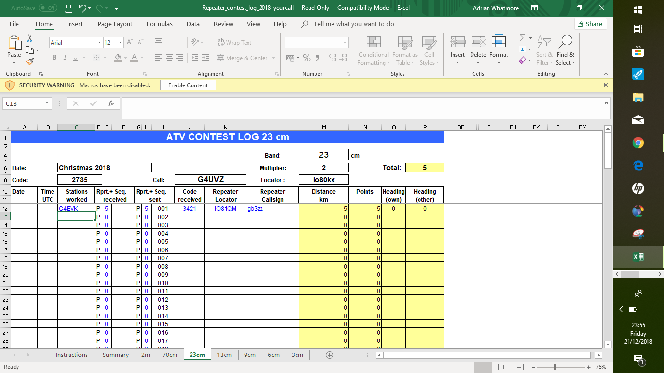

Hi Dave..Not sure if I have done something wrong but see attached ..it shows me as 5K from ZZ where as its closer to 45K??

Quite simple - you need to press the "Enable Content" button (in the yellow bar near the top of the page) to enable the Macros to calculate the distance. It can't do the calculations if you won't let it!

Thanks Dave..obviously I missed that in the instructions!,,You know my IT ability of old!

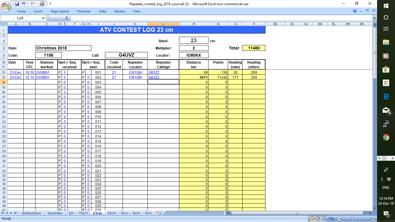

Something rather strange with the scoring in the second entry

? ,,Distance to ZZ seems to have gone the long path route>>>

Ah but just think of all those extra points!
