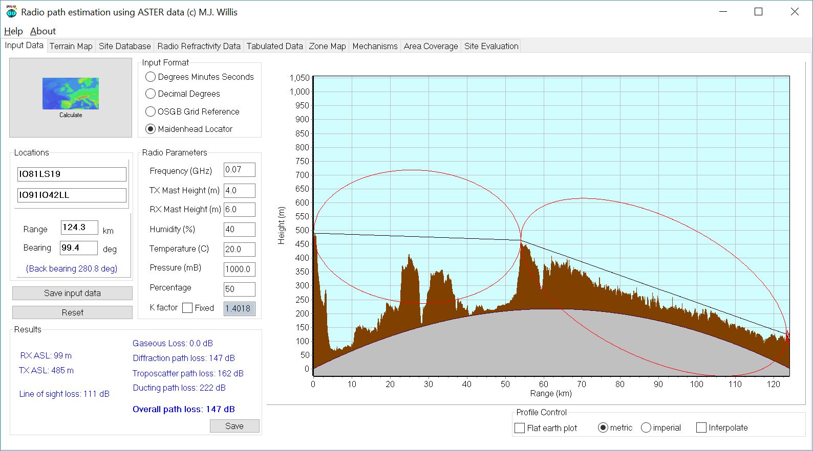

In the case of the recent tests between Shaun and myself, I know it wasn't densensitisation as both of us have tight filtering and before the pre-amplifiers. Looking at the carrier level, the 4m signals were very weak in both directions compared to 2m talkback where they were very strong. Shaun was running high power on 2m but I was only running a few watts. We know this path works on 2m DATV from tests earlier in the year. The following plot from my latest iteration of Path Profile indicates there is only one major diffraction point, IO81UQ

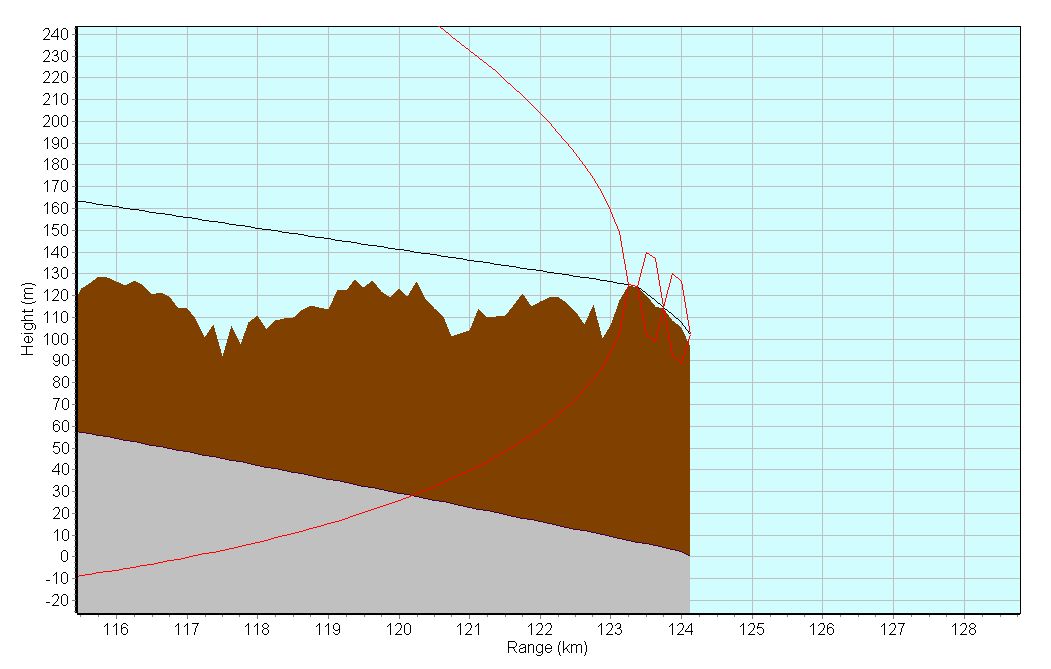

In my case, I think part of the problem was local to me, if you look carefully you can see there are local obstructions that perhaps had a bigger impact on 4m than 2m. Path Profile knows nothing about local clutter, it assumes an antenna in the clear above local obstructions. I don't think neighbours would be happy with either of the two alternatives, a 30m high mast or demolishing their houses and cutting down all the trees.
Even so, these local effects should not amount to more than a few dB and I expected 4m to be stronger than 2m which it was not. Not by a long way, 20 dB at least. My initial conclusion was one of our antennas, probably mine, wasn't happy on 71MHz. However, a quick carrier check at 70.3MHz showed little difference. My antenna is only 6m above ground, but I can hear Angus all the time on 4m so it can't be that bad. The 2m antenna is only 1m higher and that's not enough to explain this either.
