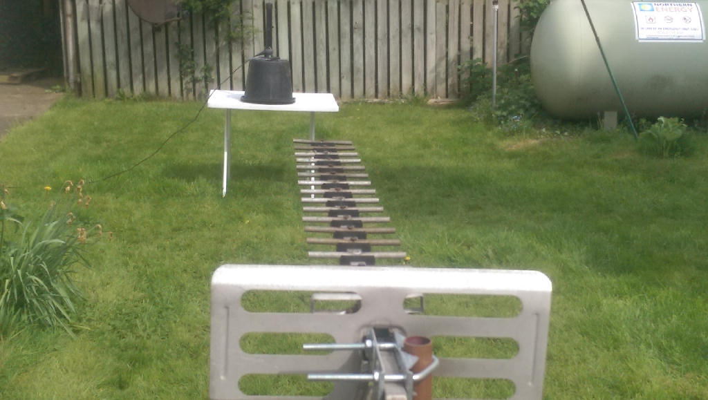

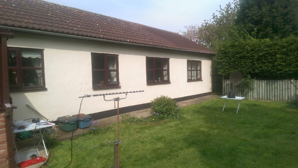

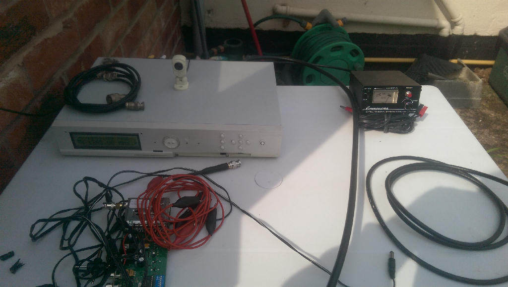

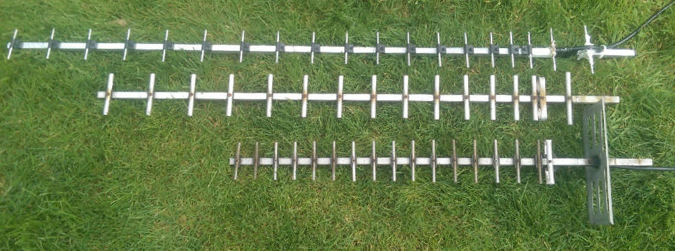

This weekend has been an AE weekend, spent most of the day in the garden yesterday.. Playing. Why oh why are these 23cms AEs soooo diferent?? The middle one turned out to be a complete dud, RF output => 0 so I canibalised it for parts to improve the top one.
[attachment=0]IMAG1488s.jpg[/attachment]
It turns out that I have been using the Best RX antenna for TX and the best TX antenna for RX.. Doh!
[attachment=2]IMAG1485s.jpg[/attachment]
For TX, the Severnside AE beat all comers by a country mile, even with an attentuator in the RX.. Blew them into the weeds it did, and other such superlatives.

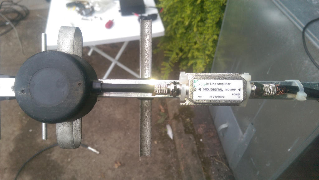

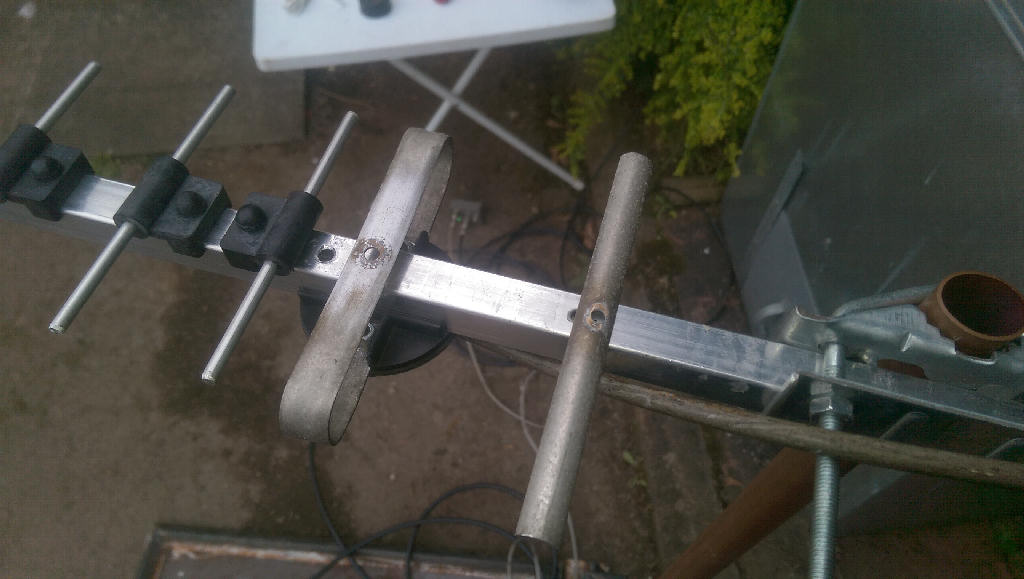

The Home made AE had a single Dipole but was best at RX so.. since the Folded Dipole and reflector on the dud were almost the same as the Sevenside I cleaned them up and did some experimenting.. Leaving them loose on the boom allowed me to move them around to find the sweet spot.. and lo. the Homemade was improved no end.
[attachment=1]IMAG1489s.jpg[/attachment]
Then it just needed the masthead preamp fitting.
[attachment=0]IMAG1490s.jpg[/attachment]
Job done.. TX and RX Aerials sorted all ready for next wekeend.
