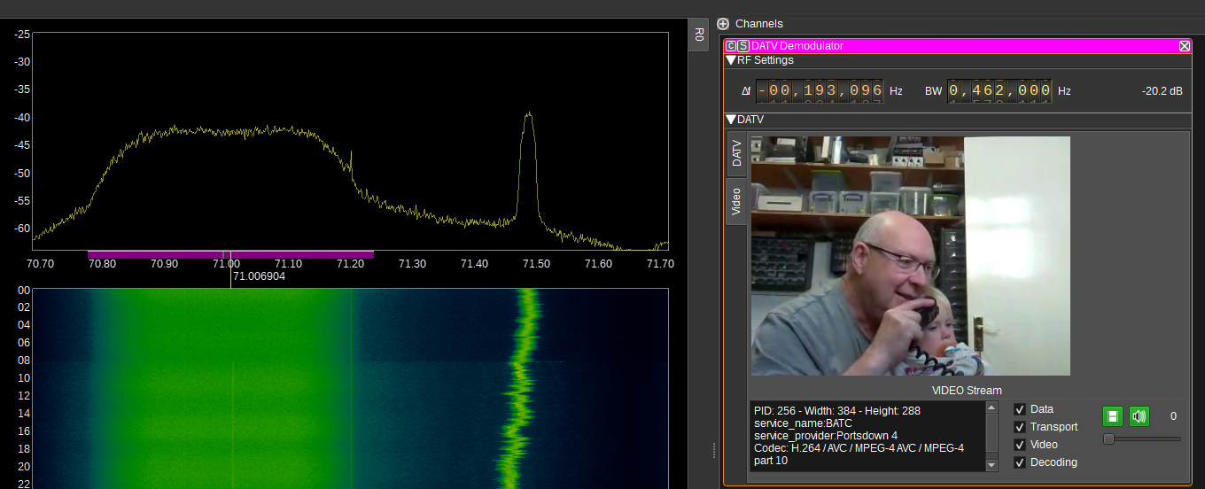

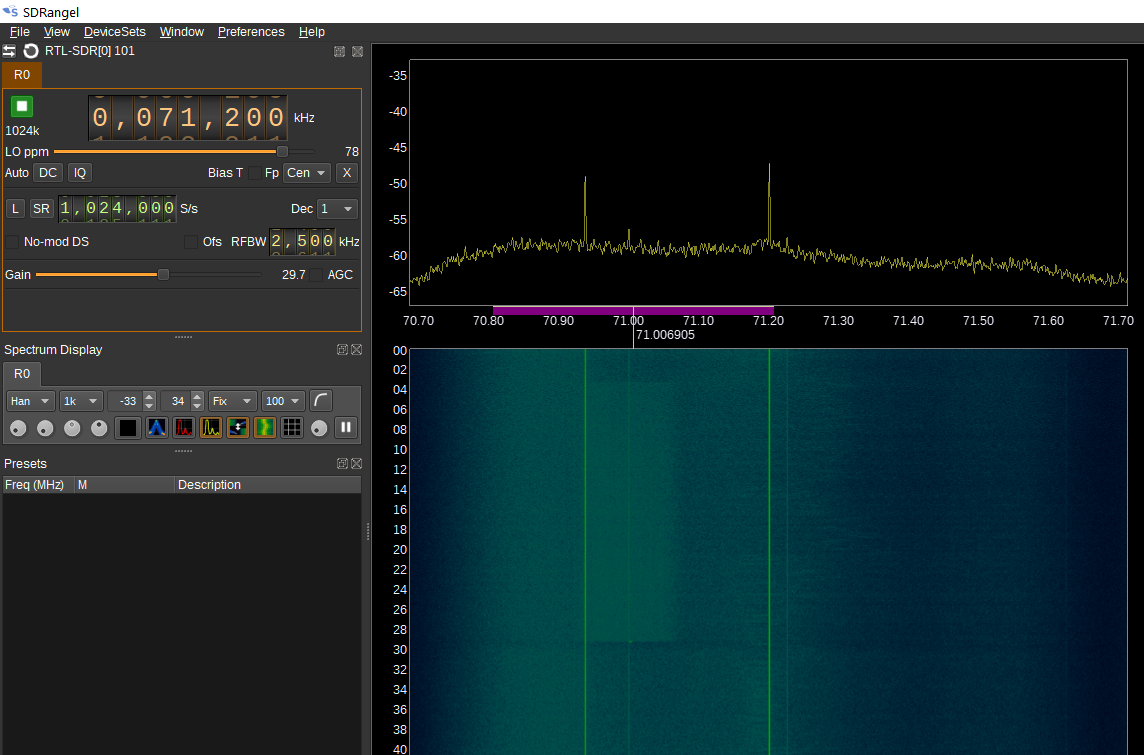

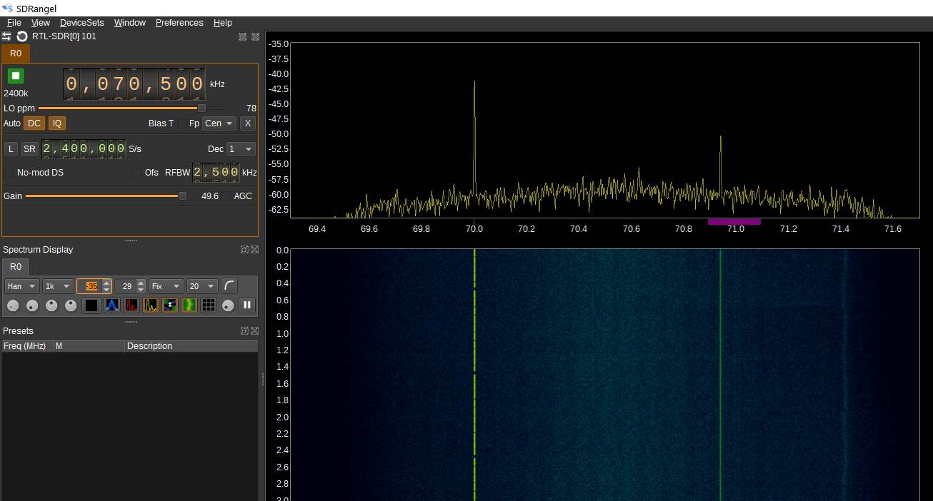

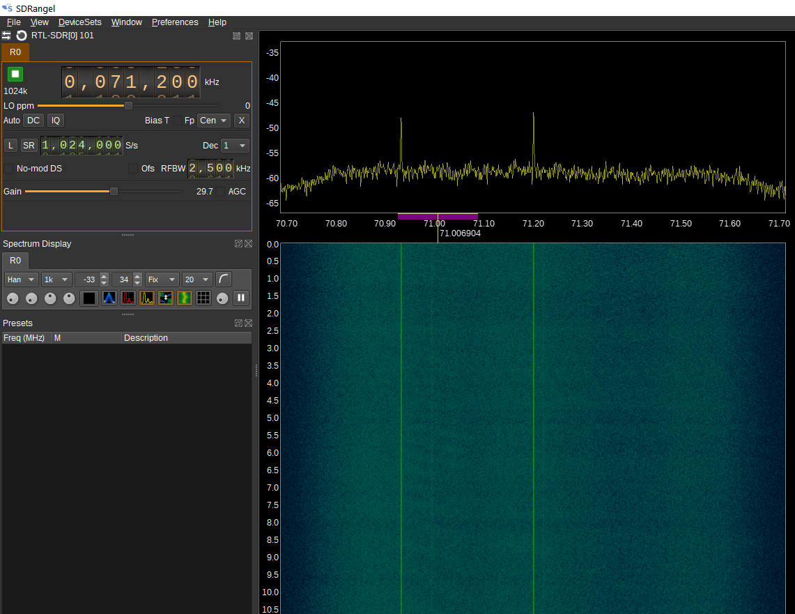

I was using SDR Angel (now that i've figured out how to get it to work) as the rtlsdr is quite low NF with the gain wound up and an old PYE filter re-tuned to 71MHz. GB3BUX was 57-59 all afternoon.
I managed one 4m qso with Clive G4FVP, this went reasonably well but not that strong.
Dave G4FRE was max 2dB over the noise and Noel 1dB so we were out of luck there.
Conditions for me were below average, Couldn't even work Mike on 144.750!
A few screen grabs attached below.

GB3BUX ~22dB in 2.4KHz
G8GTZ 125Ks
G8GTZ 125Ks
G4FRE 66Ks
G4FRE 66Ks

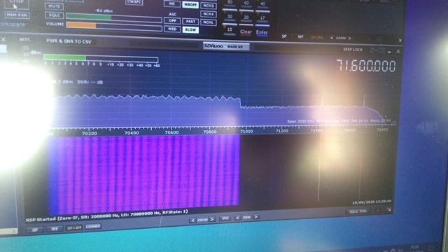

I did manage to setup for 4m, but was met with someone else's digital signal from 70.4-71MHz - see attached. And the PA string, which worked so well at home, refused to behave in the field. Anything over 1 watt and the waveform went very wrong. Software flakey again, SDRAngel and DVBSGui both not liking the weird digital interference. Portsdown/Lime was having trouble running power but ExpressDVB worked well but RF caused the Pluto to 'ding-dong' and disconnect as soon as I ran some power.

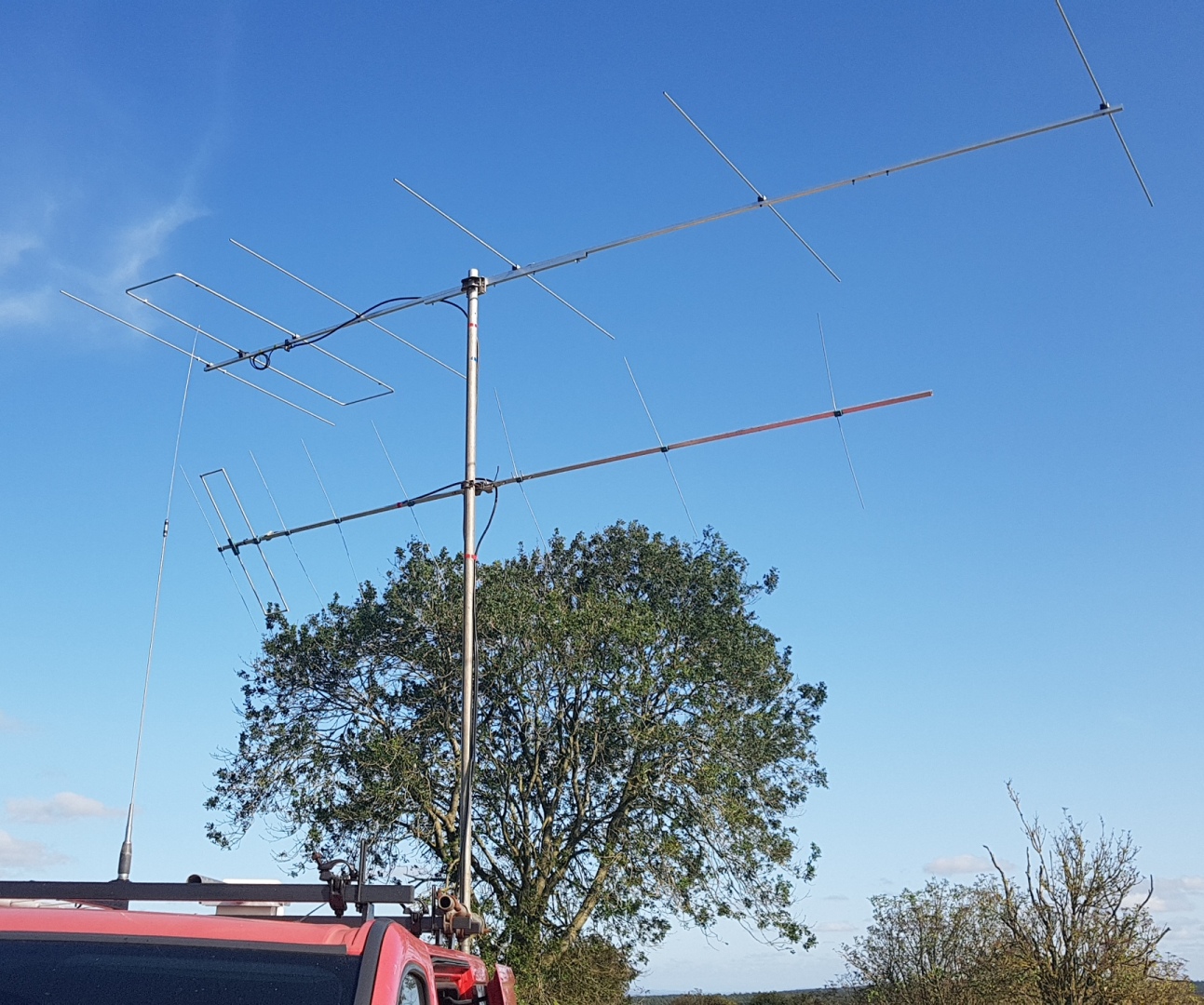

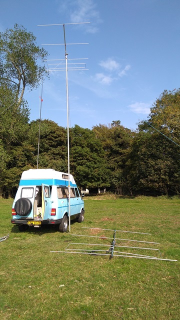

Good bits, I can assemble put up my 4m 5 ele LFA in about 20 minutes. (6m AGL). New (s/h) laptop has at least 3 hour battery life. WX was nice, not too windy at my location.

Pics show ther digital interference and my setup. 4 element LFA for 6 didn't make it into the air on this occasion.

The interfering signal Gareth we seeing looks like an image to me. It's really important to have good filtering on VHF. I can see a filter bank might make a useful new BATC project. It would not be very difficult to come up with a common inline pre-amp filter for RX with a cheap TR relay. But first check this out http://www.ha8et.hu/ as Gyula has already done this for about €60.

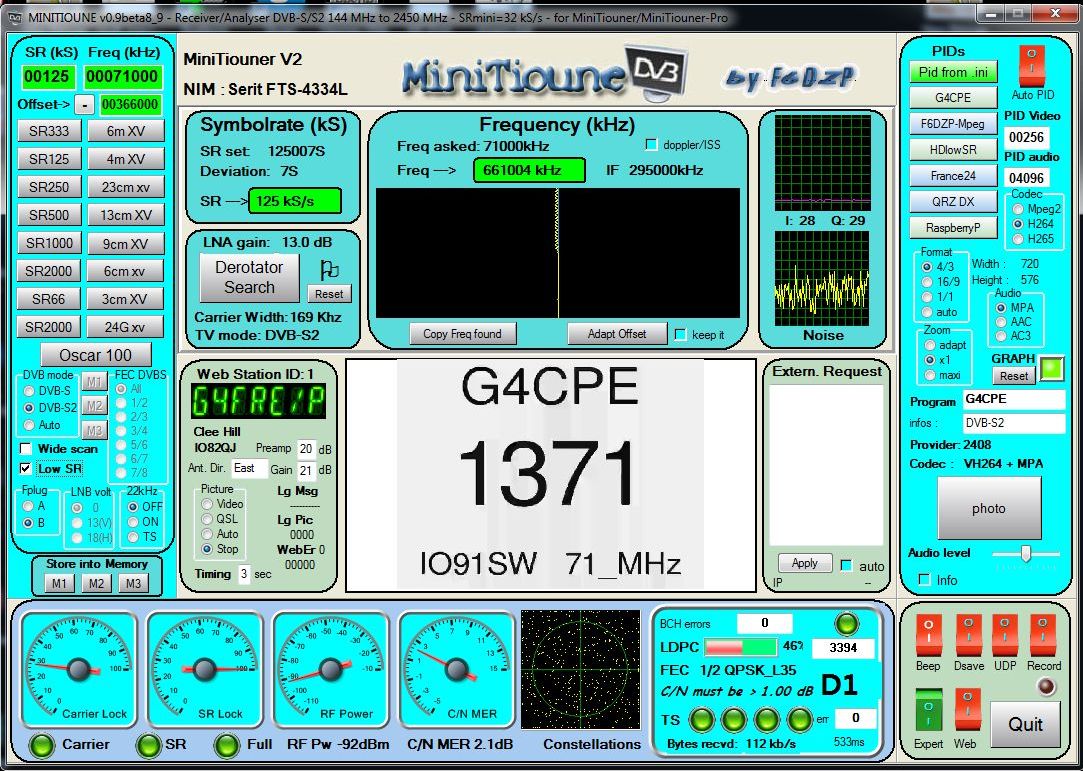

Had a 2 way on 4m with G8GTZ (MER15) Tried on 6m, Noel copied my signal easily but due to loud interference coming from the radio station at the bottom of the band I struggled to receive him, but eventually I copied him at 66ks near the top of the band (for my only 2 way qso). Worked G0MJW on 4m (MER6). Due to the fine work of Noel acting as a Zello to 2m transponder, hooked up with G8VPG and had a 2 way with him on 4m (MER 16) When he turned his beam on noel he was still MER8 with me! Tried 4m and 6m with M0DTS with no luck, but my 4m signal was detected!. Worked Arthur G4CPE (for the 1st time!) on 4m (MER peaked at 7.5) at 156km for my best DX. He could not copy my 6m, probably due to cross polarised antennas. Copied Noel at MER6 when he transmitted 4m at Arthur! Managed to get my 6m received by G0MJW in the final act of the day
On 4m used Portsdown 2019 +modified G4DDK nacton 437/71MHz transverter + MITSUBISHI brick (20W) +minituner. On 6m Portsdown 2019 +modified G4DDK nacton 437/51MHz transverter + 7w MITSUBISHI brick+LDMOS amp (150W, the bigger amp is locked down in wales)+ minituner

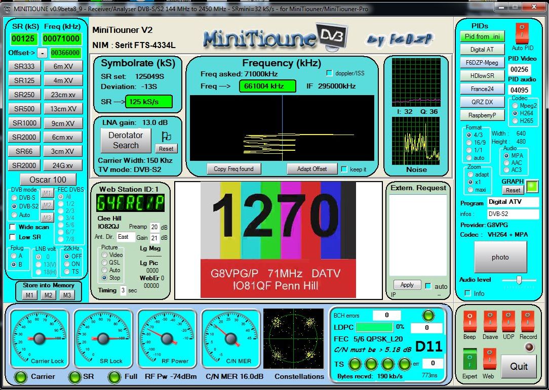

G8VPG transmitting intended not actual locator

G4CPE 4m
G4CPE 4m
