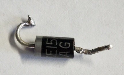

The 12.5v to 13.8v Boost converter that I've used for about 6 years in the van must have had a fit today...
This saved my Mitsubishi brick...

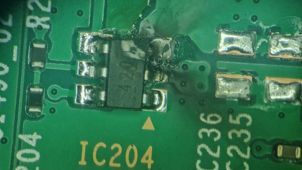

The Tv/Monitor that's also dead let the smoke out, seems to be a 4201 something, Looks pin identical to TPS564201 so there is hope!

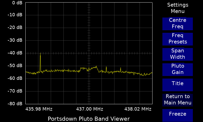

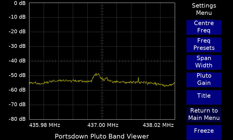

Well a lot of DC was consumed but no actual pictures were exchanged. Some interesting propagation (I use the term in jest) between Martin G4FKK and myself, just 8 miles or so apart, but with a big hump of gravel in-between us.
Martin was able to decode just the headers of my signal, no call sign or picture. On trying the reverse, a strange multipath 'double hump' waveform was seen. We peaked up our beams but it remained. Swinging a little off direct reduced the double hump but also reduced the signal.
Aircraft coming in towards Heathrow often fly along the line between us before looping around for the final approach and sure enough, this fast flutter/multi-pathing was also seen, short duration (10-15 seconds) as it was flying at 120+ mph.
We also tried aiming at the Crystal Palace tower, similar results, a double hump and no decode.
This morning I tried TXing to Rob, he could occasionally see my signal (aircraft?) and copied a 300 Watt CW carrier at +15dB. So DATV did not really stand much of a chance......
