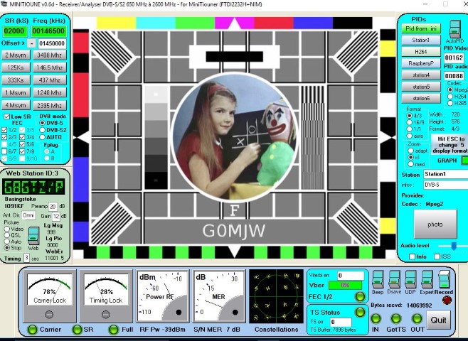

As previously reported by Dave, on Saturday I went out to IO90LX and worked G8GKQ on 5.6 and 24GHz over a 90Km path. P5 pictures were exchanged on 5.6GHz and a 2 way DATV QSO on 24GHz with Dave running an HD web cam on his Portsdown to give superb pictures at 2Ms.

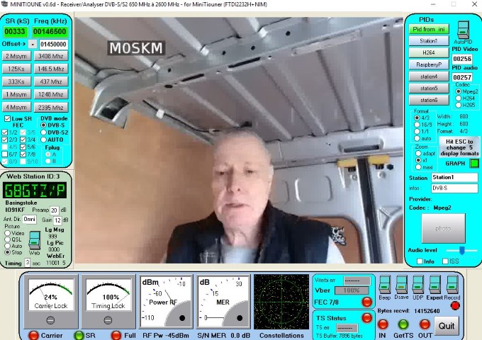

On Sunday I went to Ridgeway above Didcot and worked Steve M0SKM on 146 - I also tried to work Arthur on 146 and 5.6GHz but failed on both bands :-(
skm (Small).JPG (116.54 KiB) Viewed 7677 times

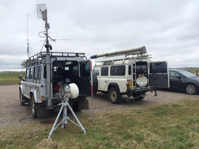

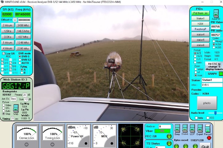

Mike G0MJW then came up to site and we tested his 24GHz gear which had not been turned on for 10 years and had a DATV QSO over a 3 metre path!
IMG_4041 (Small).JPG (94.55 KiB) Viewed 7677 times
But we did notice some very strange constellations on 24GHz - these were not there on the 146MHz IF signal but reproducible on the 24GHz link :-)
mjw (Small).JPG (127.17 KiB) Viewed 7677 times

Our 16 APSK signals were also only present at 2MS/s. They disappeared at other rates. Very strange, as this was completely repeatable. Maybe the proximity had something to do with it. It wasn't IF leakage as I was only putting the Portsdowns 10mW into my transverter and signals disappeared when the transverter was off. My PI camera has stopped working again and my C920 is on loan, so only testcards sent.

I saw something very similar to that (quad points in each quadrant) when I was doing some Pluto testing with Minitioune.
It turned out to be due to restricted transmit bandwidth, when I opened the Pluto's analogue filters up the problem disappeared.
Maybe the BW of your 24 GHz transvertor is not as wide as you think.

We thought about this too - its not likely to be my transverter but the 2m IF at the receive end. Noel was using his 2m system which has narrow filtering to keep out all the pagers etc.

As Mike says, we think that was the problem as I was using my standard 146.5 MHz rx system which has a multipole Pye Europa filter at 146 followed by an interdigital at L band so is very tight and we were running 2Ms on 24GHz - all previous 24GHz tests had been done using a Serit tuner at 145 with no filtering.
