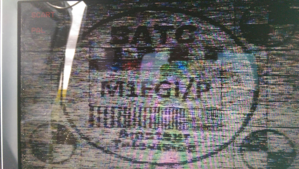

The Picture received from Gary using the Comtech PCB receiver, inline Preamp at the AE head.
[attachment=1]IMG-20170417-WA0014.jpeg[/attachment]

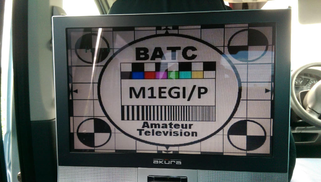

Remove the AE from the Comtech and put it into the Amstrad SRX200 Satellite Receiver, boom!
[attachment=0]IMG-20170417-WA0024.jpeg[/attachment]
I always thought that the Comtech was gonna trounce the old SRX I couldn't have been wronger, I have lugged that old SRX around on the Parcel shelf for over 20 Years. Looks like it will get lugged around for another 20.

Re Comtech vs Amstrad - to be honest, there shouldn't be that much difference and it looks like the Comtech has a fault. I've used both and generally the Amtstrad is worse on the narrower band ATV transmissions as the filters are designed for 27 MHz satellite and are wider than the Comtech.

I figured that the SRX should be worse for the above reason, I have another comtech Rcvr so I might try a comparison with that one next time round, but meantime I'll look on T'interweb to see what mods are/were possible.
