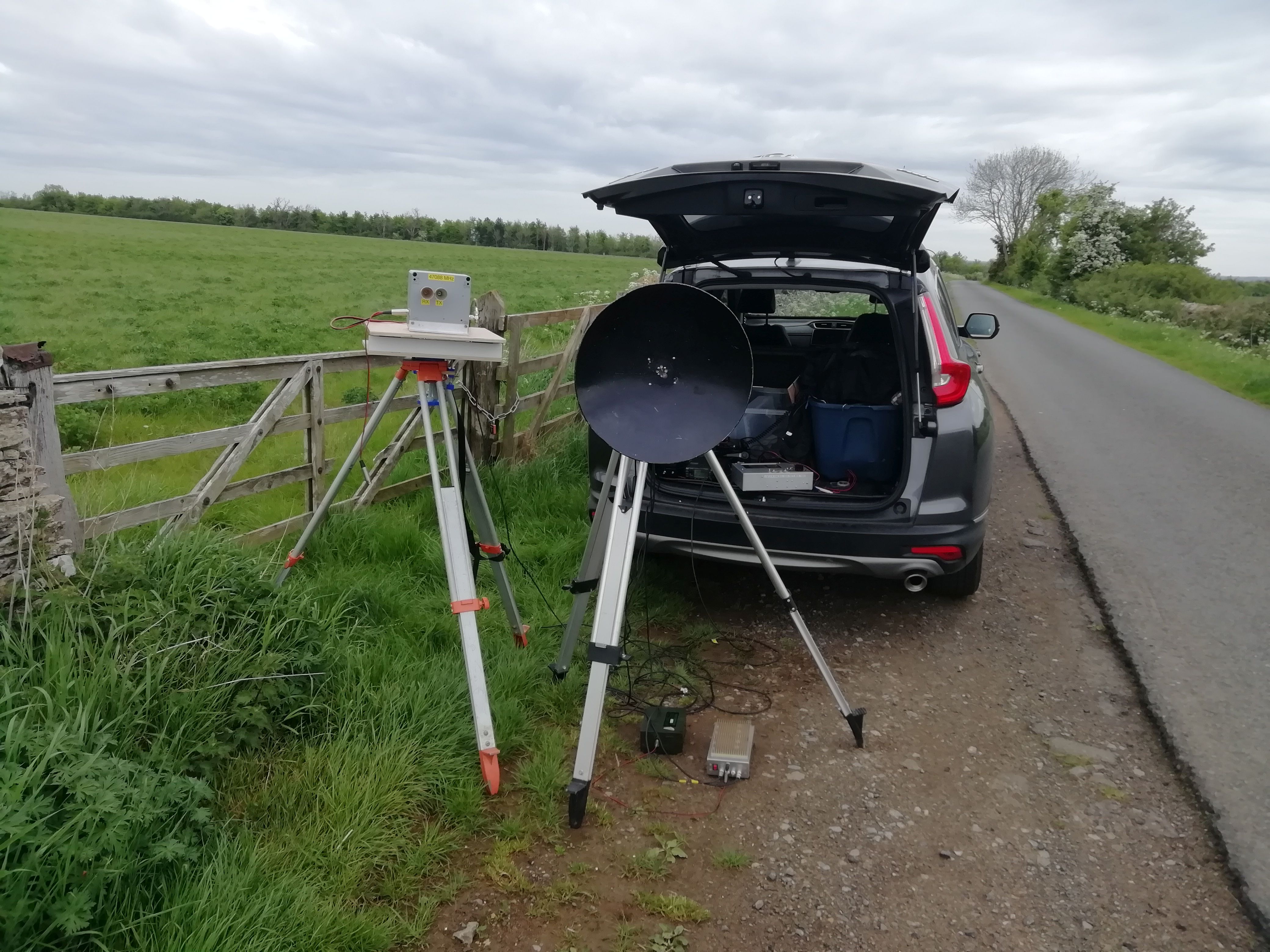

1 watt out at 10GHz, LO on 2012MHz with RX and TX IFs conveniently coming out at 2320MHz. Wiring and power supply information was found in a Scatterpoint article, thanks very much to Maarten PA0MHE https://groups.io/g/Scatterpoint/files/SP2108-A4.pdf Perusal of other internet forums found some discussions about the best LO and IFs to use to take advantage of what the system was originally designed for. As you can imagine, a Pluto will work well with this unit. The LO was provided by a slightly modified eBay ADF4351+keypad/LCD which proved adequate on 10GHz. A C/O relay was added as close as possible to the dish feed, built to this article http://www.w1ghz.org/QEX/circular_wg.pdf and all mounted on a 65cm offset dish I 'recycled' from the dump about 20+ years ago, when you could surreptitiously do such sensible things.

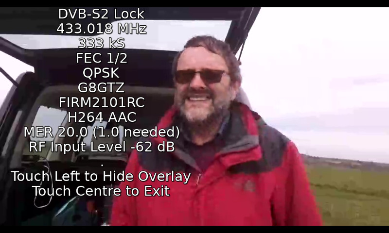

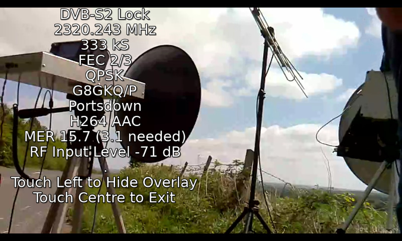

And it just worked.....first contact was with Dave G8GKQ and also Martin on NB FM courtesy of the wonderful Langstone software. With dishes aligned and tweaked (using my own Tilt-O-Matic) we switched to DATV and had a two way with MERs of around 20. Pleased or what
This was a first for me, thanks Dave. Swinging the dish around to Noel resulted in similar results with great signals both ways.

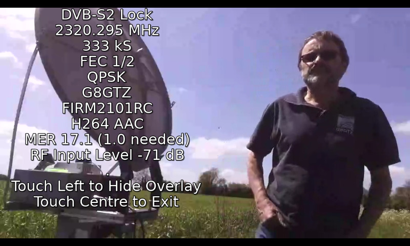

From the same vendor, a rather nice looking assembly was seen, offering a whopping 2Watts at 24GHz. This understandably produced a lot of activity and ways of making it work. Thanks to the work of SQ1GQC and others a suitable interface board (LO, TX & RX IFs'' plus the various voltages) was made available pretty much at cost. This was assembled with a suitable relay and even shorter SMA leads. With the LO being multiplied by 12 (1808) I did not expect it to be 'bang on frequency' so it took a bit of searching until I found Noels signal (450kHz high my end!). But it worked perfectly, a 2-Way NB FM conversation being had on 24GHz for another first for me. Signals were 5/9++ so as expected, a DATV contact then followed with MERs also around the 20 mark
Swinging the dish back around to Dave and peaking the signal resulted in similar reports.

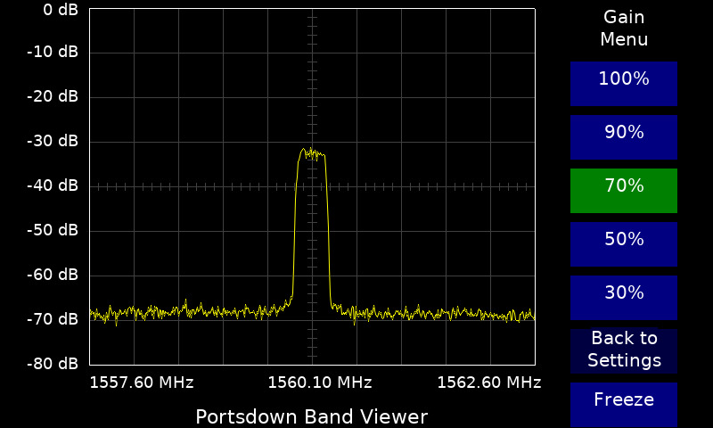

Great signals to and from Gareth G4XAT (Thruxton Hill to Butser Hill 52 km LoS), including the incredibly clean 5.7 GHz signal seen below on BandViewer.
The path to Noel G8GTZ at Hannington was only 31 km but double obstructed, however we did manage a 2-way on 10 GHz 333 kS; see the second BandViewer shot below.
